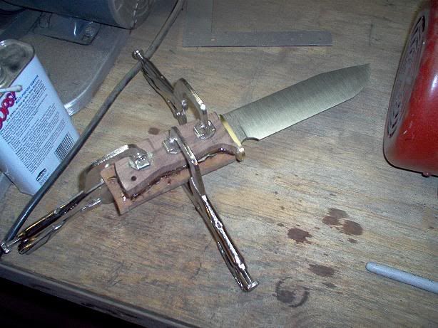

I've got a large Tusker that gets a guard so I thought it would be fun to post how I do it. When getting the knife ready, a slot should be filed at the bottom for the guard to snug up tight and not shift back and forth.
First, I cut the piece of brass according to the width of the knife. I extend it 3/4" for shaping.
Next to the milling machine to cut the slot. This is a 1/4" thick knife. The slot milled will be 1/4".
Once it's slotted, it needs to be squared with a file.
Once it's squared it's fitted to the knife.
Next to the slack belt for shaping the oval shape.
Once it's shaped then on to the 1 1/2" contact wheel to rough shape the finger cut out.
Now it's ready to be soldered.
After it's soldered, then the handle scales get attached. This will stay clamped overnite. Tomorrow I'll post finishing the guard and completing the knife.

Like the tutorial, thanks for putting it up; any chance you want to add the soldering methods onto it :-) That's the part I always have trouble on!

Ray, I solder from the backside where the handle meets the guard. Soldering is done the same as if you were soldering two copper water pipes together. I use a soldering iron and a propane torch. Put the solder along the crack where the guard meets the tang. I use liquid flux on a Q-Tip. Too much flux causes corrosion along the guard and ricasso. heat the area to be soldered with the torch and melt the solder with the iron. You may have to run the torch flame on the area if the iron is not melting the solder completely. Takes some practice.
