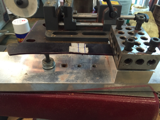

The first time I saw something like that Jig set up was from Nick Wheeler. Of course mine is not so engineered :) and it is cobbled together when I need it but it works well.
I take a flat piece of stock mount a flat piece of aluminum or even oak on top large enough to give me the clearance I need. In the picture the bolsters give enough clearance do additional piece was needed. Then I add shims and use tape for a snug support.
Once clamped tight this will level out the blade and when you drill your holes will be perpendicular to the long axis of the blade. I ca glue one side on temporarily and drill the holes, then flip it over and mount the other side and drill through the original holes through to the other side.
Viola the holes line up perfect for pins or corbys
