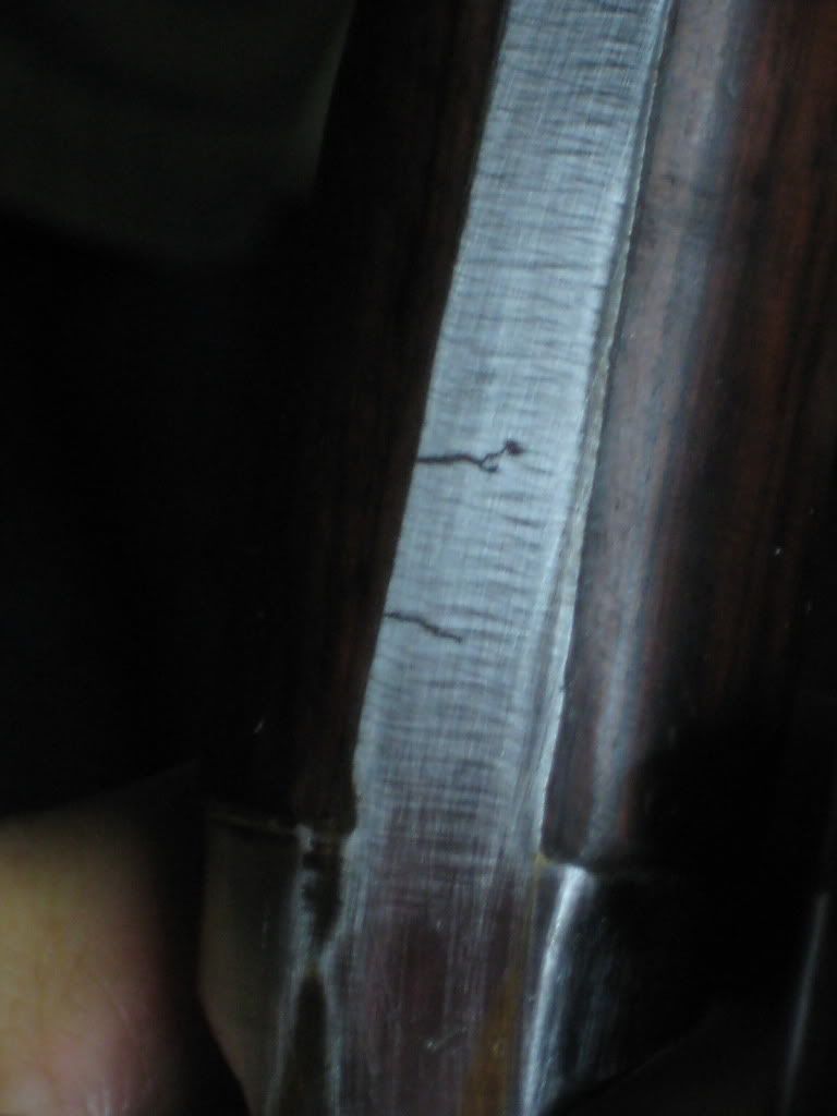

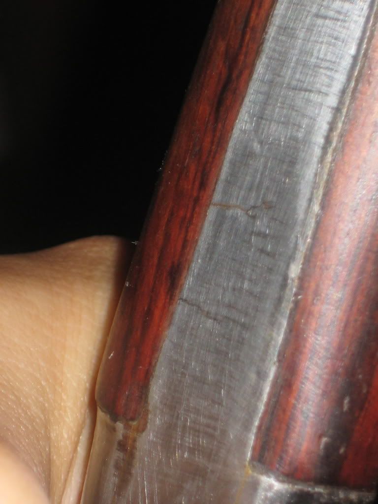

Hello guys,
Asking for opinions and advices.
I noticed 2 hairline cracks on the handle tang and i'm thinking of getting it removed and welded.The problem is i don't know how deep it would be.
The crack line is about 5-7mm in length and way away from the rivets.
The metal epoxy won't help much in the future.
Will consult a knife smith about the cracks. Trying not to burn the scales.
Your input is very much appreciated.
I've emailed Auntie about it and i'm not planning to send it back. My intention is to repair the tiny crack and continue to use it. The blade had gone through some rough yet a very sentimental part of journey and it's very special to me.:D

Crack's on the area in the handle where it is under compression when subjected to chopping forces.
I would use a small drill to drill multiple times at around 1/2 a cm deep creating a v-groove.
Then I'd weld it and then grind the excess to flush with the handle.
What about you guys, any risk from this method? I believe it is the best method. Just need an experienced welder and try not to overheat the tang too much.

As a Certified Welding Inspector I see cracks in weld from time to time. As others have said, these small cracks are probably not an issue. If the knife were mine and I wanted to repair the cracks this is what I would do:
1) remove the handle scales
2) use a grinder to very carefully grind out the cracks. Do NOT get the area of the cracks too hot as the cracks will run.
3) use the GTAW method or Heliarc as it is commonly known to weld the the tang close to the original dimensions.
4) grind to original dimensions.
5) replace handle scales
Good luck with what ever you decide.
The reason for using Heliarc is less heat input as opposed to stick rod. The welder should take his/her time and not let the tang get too hot, otherwise it will become hard and brittle.

Jay,
When you did the V grooving, were you able get to the bottom of the crack?
If so, was it rather shallow?
The reason I ask is that if the cracks are shallow enough, I would just file/grind the handle keeping the present shape, but removing the crack.
Welding always induces changes in the metal, and doing it with the scales attached will likely make for contamination in the welds. When hot the laha will go liquid and run.
As Wovoka stated removing the scales is the only way you can be sure you have gotten to the bottom of the crack. If you do that and find the crack is shallow enough, you would be better opting for a reshape of the handle and skip the welding. If the handle is large enough you may even come up with a better feeling handle. I have reshaped many a handle from HI to make it a more comfortable size and to make the wood /horn look its best.
Welding should be a last ditch fix as you can come up with more problems than you started with.

I personally would not have done anything. There is a lot of metal in that tang and it isn't uncommon to have small inclusions in steel when it is forged. Chances are good that the cracks are superficial and represent no danger to the knife. I would simply keep an eye on them to observe if there was any change in their size after use.

To Andy and everybody's 0.02 cents, i decided not to weld.
Choice was made right after a rather extensive testing on the tang. I attempted to chop a huge log and i just kept pounding the blade.
The next best thing was- once done with the cleaning, the temper lines building up across the blades came right out with the application of mineral Oil.
I think i had just toughen up the blade. Those lines are just AMAZING!
Like what Yvsa said before, test it out and TEST IT HARD the 1st time.
I noticed the cracks on the handle wasn't as bad as i expected and it instilled a strong confidence with the ASTK.
I love mine even more now.

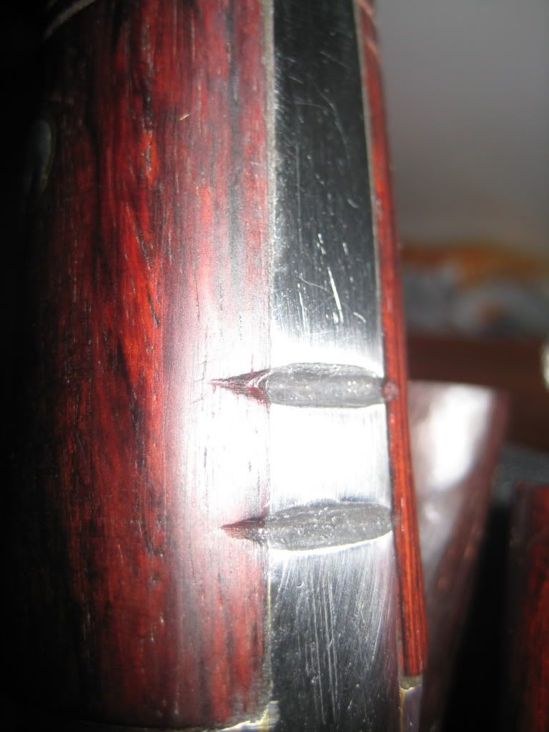

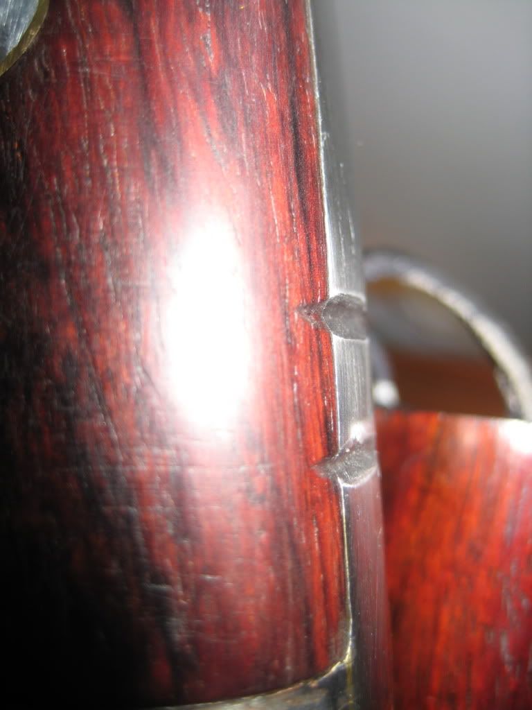

Nevertheless, i did file the crack to V-groove and check just how deep the crack went to.
The one closer to the bolster went off after 2mm of steel removal whilst the other are still visible. I then applied super glue onto the grooves and the glue sank right off into the deeper cracks. Of course this is to "seal" off the depth of the cracks.
Sanded off the excessive glue and then applied beeswax to the wood. Another layer of mineral oil and now it's battle ready.

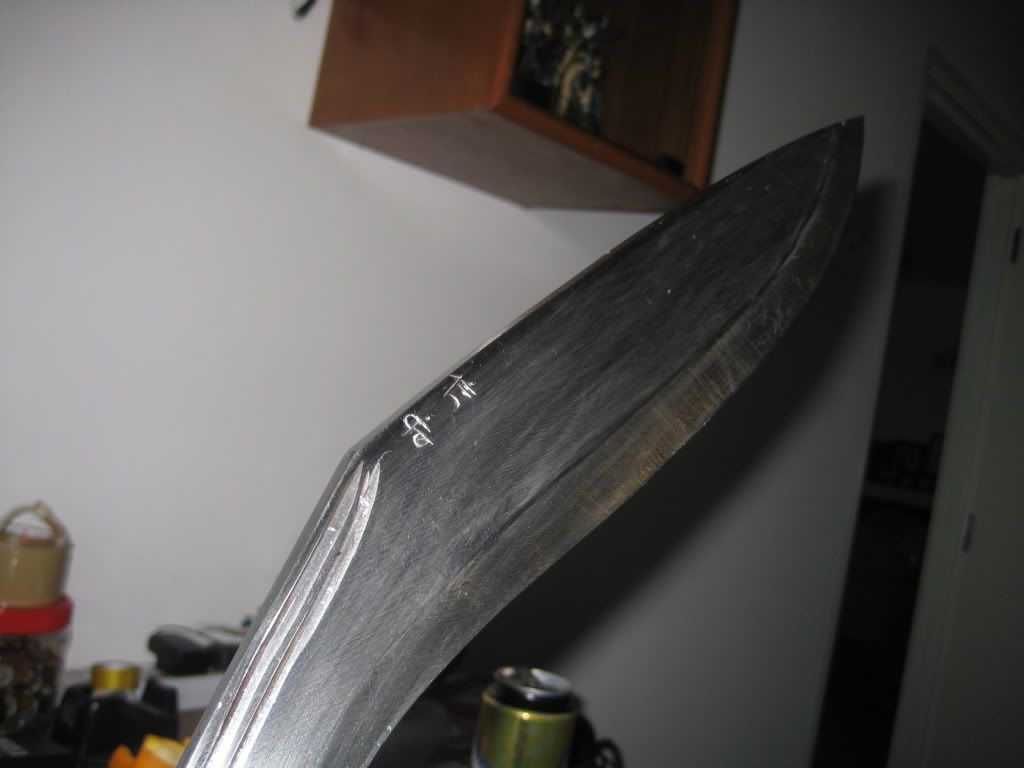

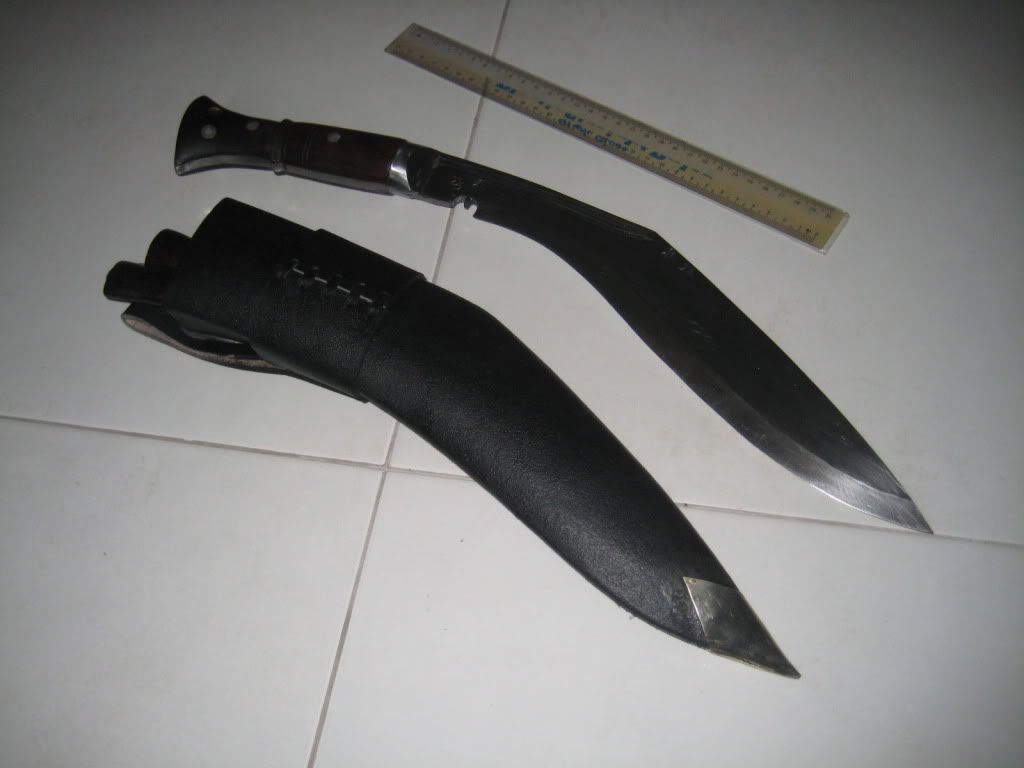

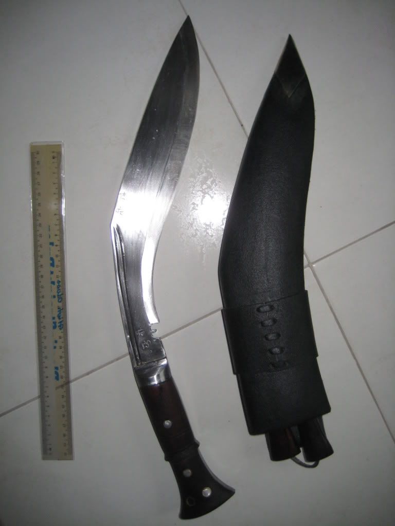

PICTURES GALORE!

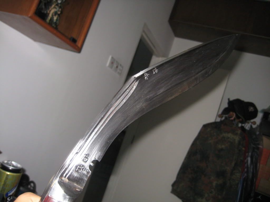

You can see the tempering lines running wild across the blade. This is beautiful!
Massive 1/2" thick!
Notice the brown edge on the sweet spot. It's trapped dirt.

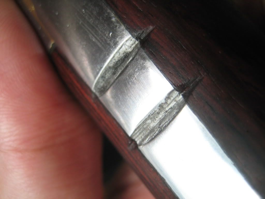

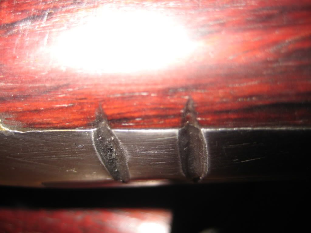

Epoxy removed and V-grooved at 1-2mm thick. Used multiple filers to reduce damage on the wood.The 1st crack was gone but the 2nd one still stick around.
It's looking more like a hairline crack.
Applied super glue.
Excuse the dried glue but you can see the cracks. Nevertheless, i whacked it real hard before on a thick log and it's pretty much indestructible.The crack didn't grow. I should update if there's any cracks later.

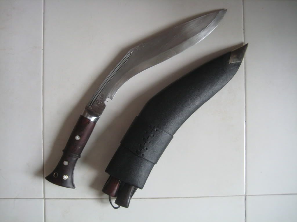

ASTK managed to convince me it's a workhorse.
Amar Singh Thapa must be very proud of it!
