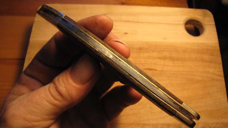

I found this Camillus fishing knife in an old shed. I have some nice black walnut I want to use as scales to bring it back to life. The liners are a little bent-- so I'm not sure how I'm going to straighten them out. Any other project knives out there, fellow forumites?:)
If you're referring to that straight line crink across the middle of both liners, that's supposed to be there. A very old assembly trick -- they smack it there to slightly cup the liners. When the scales are then pinned on, the cup flexes mostly flat but retains a bit of spring, making the liners "seal" to the scales without gaps and without any glue being used.

The tip of the blade on mine is rubbing on the liner opposite the lock, so it seems a little out of wack or twisted. The blade isn't bent anywhere. It will be a fun project! I'll post pictures when done.

AAAAND........ Done!
The handle lined up pretty good after adding the scales! It's not perfect but it will make a nice user now.:)

Did you completely disassemble and repin or did you just add scales somehow? I have a Fight'n Rooster toenail that has ugly celloloid pulling away, and has some other issues as well. It is definitely a project, but I have no clue where to start.

This project was facilitated through the magic of 5 minute epoxy.:)
I sanded what was left of the pins flat. I guess I could of carefully drilled out the old scale pins and added new ones, but that epoxy is STRONG stuff!!!!
I just sanded the wood to fit the spaces (carefully) with a belt sander. I glued them on and clamped them down tight to try and get some of the flexes out of the liners. After a couple of hours I sanded down the scales. I did the edges with a dremel tool and the slack of the belt sander. When it got close to the bolsters I switched to 400 grit and took it all the way down. I tried to be really light over the writing on the bottom bolster. Polished it up on a buffing wheel and added some oil to the wood.
