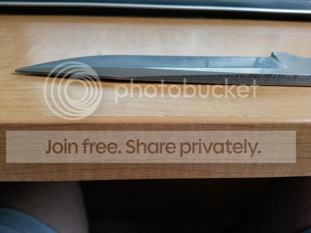

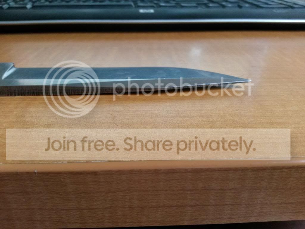

Hey guys,
I have a 3V utility knife that I had heat treated come back slightly bowed. The blade is almost completely finished and I just now noticed the bow :mad:
I surface grind most of my blanks before doing bevels to get everything flat and square but the chuck is strong it likely flattened out the bow in the blade while surface grinding and I didn't bother to check for straightness afterwards.

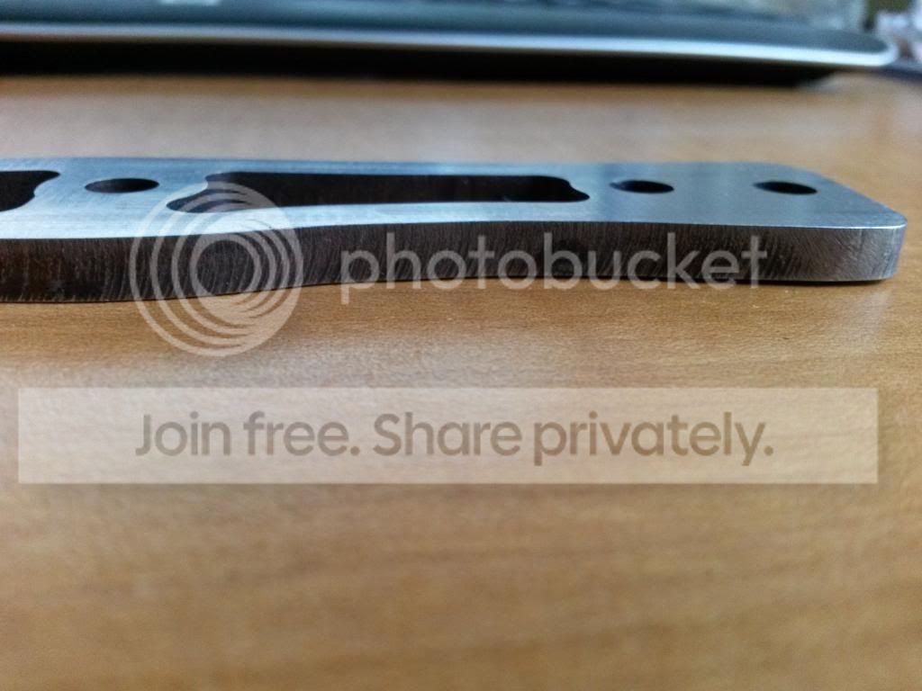

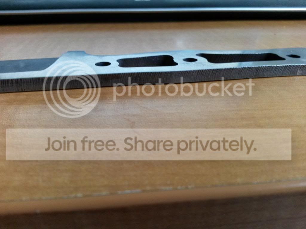

So here's the problem. There's about .050 of a bow across the entire blade and I need to get rid of it without inducing stress or harming the edge.
Whats the best method to use? This is a pretty thick blank at .21 and I've never had to straighten an air hardening steel, let alone one that tempers so high. My current plan is to shim it up in a vice, heat with MAPP gas to about 4-500 along the spine and tang and then tighten the vice and let it cool.
That is very little bow, but I know how you feel!!!! I've used a couple of C clamps, a bar of scrap steel, and a small nail as a fulcrum, all placed into the oven, to take out a bow. But the warp I had was severe. Tweaking those clamps to get that small of a warpage out might prove difficult, IDK. Maybe worth a try? Clamp the bar of scrap steel to your blade, parallel, with one clamp at the tang and the other towards the tip. Place the nail between your blade and the scrap steel at the apex of your warp. Tighten one of the clamps until the blade is COUNTER bent the other way. Over-bend it just about as much as it was bent the other way, and place that whole contraption in the oven. Not sure about temps for 3V, but 400 works well for simple carbons steels. Once it is done, you can take it out and check. You may have to do this a couple of times to get it dead straight. Some have suggested dowsing the blade in water while it is cooling down while still clamped. Never have tried that approach, tho. This clamping method worked PERFECT for me to get a bow out of a 13" oal knife that was .065" thick. I hope it works for you, or someone might have a much better suggestion.
The three point straightening process should work fine. Do it at 400F, not at room temp. repeat as needed (400F each time0 until youget it out.
On my 4th attempt using the 3 point system I cracked the tang :mad:
didn't bend at all before cracking and is still bowed. It may not be possible to fix such a small a bow on thick steel.
Damn. Had the whole blade finished and got greedy. $100 mistakes are not ones you easily forget I suppose.
