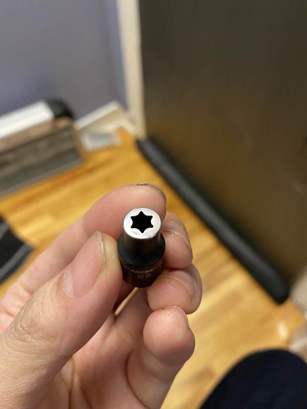

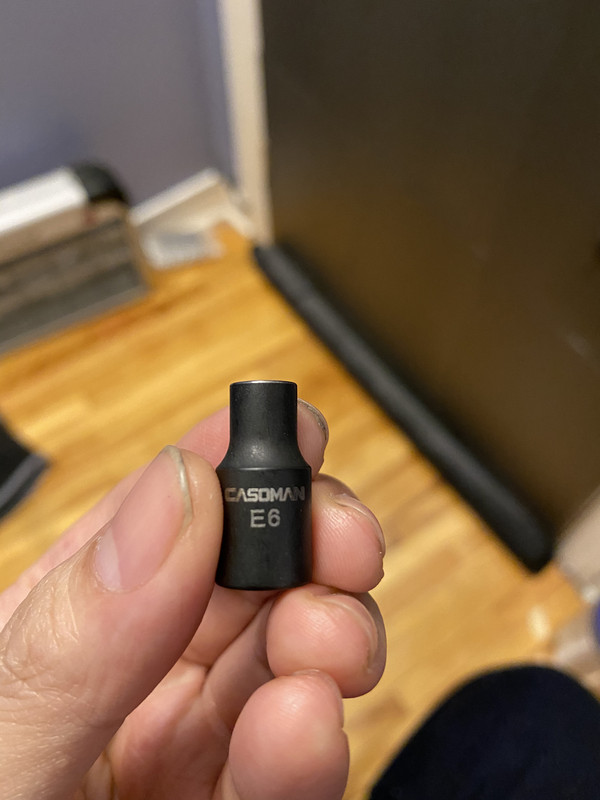

View attachment 1488342 The lock bar has a staked nut at one end and a loose nut at the other. You need 2 TORX sockets to get the thing apart. You also need to remove material from the tips of the sockets to gain access to the nuts. Be careful with the heat as the bearing cages are plastic.
2 torxs isn’t required to remove the lockbar as it has 2 flats that sits inside the groove to prevent it from spinning. All you’ll need, is one E6 modified female torx and unscrew the one on the pocket clip side. Also, when you reinstall your lockbar, you’ll notice, it will just go in on one side only and will not get in the other way.
Personally, i tossed away those cheap bearings and swapped with a more durable PB washers.
You might have a newer model, my lock bar spins freely.
