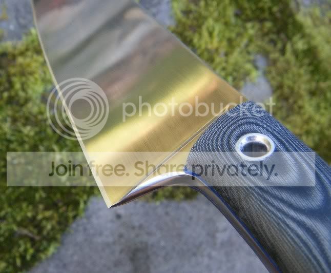

I flare mine. I wouldn't use this for bone, stag, or wood handles. G10 and Micarta can take it, though :D
I countersink the handle material and flare the tube into the space. I use wood for all the knives I've made so far and have yet to split one using this method. I tried on the first one, flaring in the vice. I split the brass tubing, but the wood held firm. Micarta or G10 should be all but impossible to split. I flare mine with some screw heads with the shanks cut off. The 45* angle counter sink bit matches the angle on the bottom of the heads. I've only done 2 knives this way, but the wood was fine after both. It may split with time, but no signs so far. If you can do a search, I learned from a tutorial Flatgrinder posted a year or 2 ago.
Thanks for the pic. I have new inspiration for some old forged bolster chef's knives I was asked to repair. I hate those bolsters. Now they're coming off.
