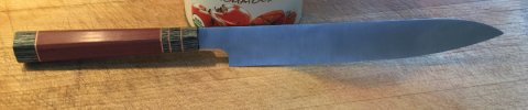

I’m kind of concerned about the length of your tang on that blade.... how long is the blade? I Don’t use very long tangs but that one looks kind of short
Harbeer - you are correct. Long story .... I created the profile early last summer before I had experience making Wa style handles. The tang was originally longer, but as I learned more about how the various dimensions of the Wa (and its relationship to the blade) stack up, the tang had to get shortened, otherwise I would have compromised other dimensions of the blade. I could have trashed it, but I wanted to practice the multi-layer construction of the Wa handle, AND I really kinda needed a long, thin, slicer for Sushi .... so I decided to go ahead and assemble it. Here is the final result:
Kind of a Sujihiki (but not quite correct shape), blade stock is 0.06" (so does not put a lot of stress on the tang), and surprisingly, the thing balances right at the pinch point (blind luck). It ends up working very well for slicing Sushi (hmmm, that sounds good for dinner tonight...
(aside - the lengths of the various sections of the bolster and the and piece are defined by the "Golden Ratio" - another thing I wanted to try. I am pretty happy with the look :-)
Nowadays, I target 3" for an embedded tang length. With the gentle use of this blade, it might well last. If not, I wont cry (I learned a lot from making the blade and the handle) .... and I have a Yanagiba in-process (but the blade is not as long :-( ).
