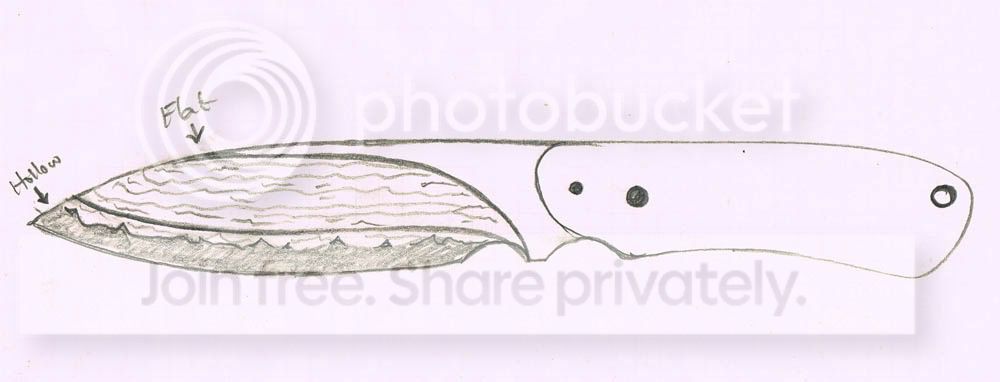

I have a piece of SanMai from Mike Turner, it is a beautiful piece but I didn't realize the 1095 Core was thin and made to be hollow ground so that the core is more "Exposed". I have already flat ground the blade...
Has anyone done or have examples of a knife that was flat ground then put a short hollow grind around the cutting edge?

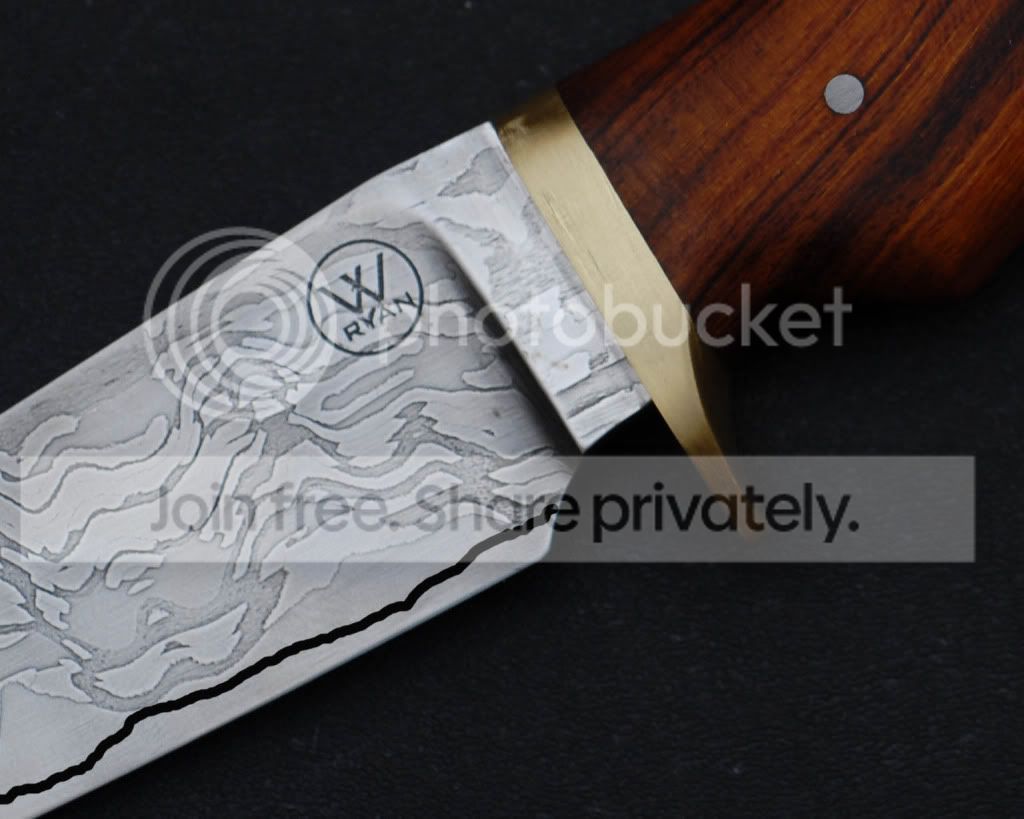

Thanks for the reply Rick, I believe it was made specifically to be hollow ground, It is actually Chainsaw blade/1080 Powder Damascus with a 1095 Core. The damascus mixes in with the core when it is so close to the cutting edge. I am not a big hollow grinder either, but I think it will push the core up higher on the grind (Does that make sense?). I have example of the Steel but the core is much lower hopefully this will help show what I mean
The black like I drew in is where I anticipate the core to start...

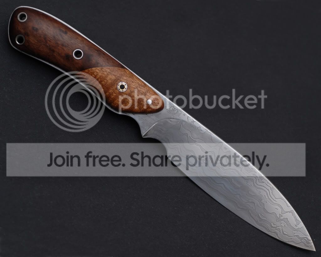

Here is what it came out like, I still wish more of the 1095 was exposed but lesson learned.
