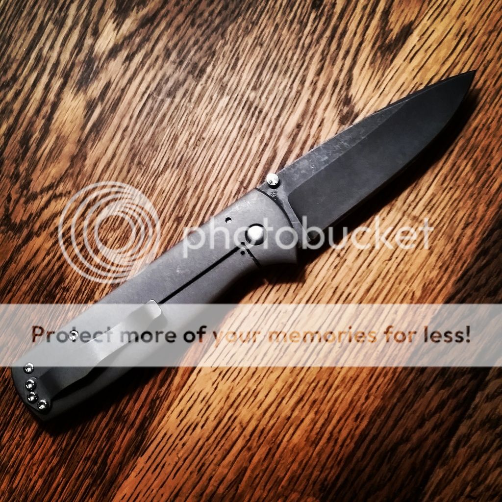

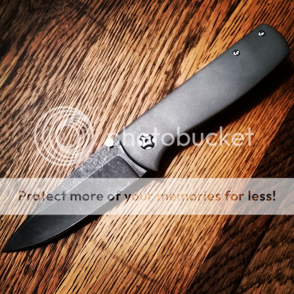

Here is the project that I have been working on. I've been wanting to learn how to make folders for quite a while now, and I finally decided to just go ahead and give it a shot. I went with a frame lock for my first build since that is what I prefer to carry. A mill would have made things a lot quicker and easier, but I still got the job done. I'm really satisfied with how this knife turned out. Let me know what y'all think!
It looks highly functional and comfortable. I like the no nonsense finish too. That gonna make someone a fantastic user. What steel are you using?
I'm holding on to this one since its the first one I've made, and I decided to go with CPMD2. Once I start making more of these I will be using CPM154 as well, and possibly some other steels later on down the road.
Not a ton of D2 out there, it's one of my personal favorites. Great job on your first build! You have real talent.
Cool project Jarrett. I like the overall pattern of the knife. The dark gray finish looks very practical. It looks like it will develop some nice character after it has some pocket wear. The only detail that catches my eye as being less than your perfect standards is the short leg of the liner lock cut-out in the handle scale. What tool(s) did you use to cut the slots? I imagine that the big manufacturers use wire EDM or water jet for cutting those slots. I am curious how you do those cuts in a one man shop.
Great job on your first go at making a folder. I look forward to seeing where you go from here. Thanks for sharing the photos.
Phil
I used a dremel cutoff wheel in the drill press. It's the only thing I had to do the job. On the next one I'm going to drill a hole at the corner so those little legs won't be there.
A lot of makers have their frames cut out by a water jet and I may decide to go that route if I start making many of these at least until I get a mill.
