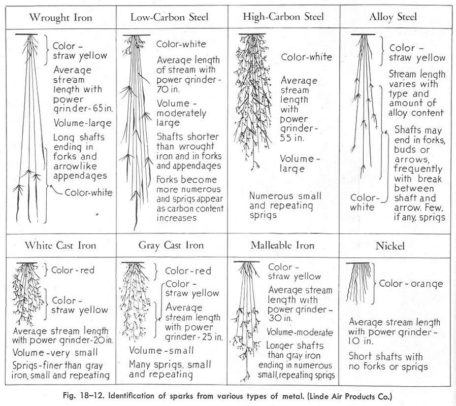

I don't think this is quite correct. The carbon content of the steel also changes how it sparks, regardless of its heat treatment. High carbon steel throws more and brighter sparks, with numerous branches like a sparkler, compared to mild steel. This is the basis of the "spark test" to figure out what kind of steel a piece of mystery metal might be. I see this in my garage all the time, when grinding annealed O-1 and/or mild steel on my bench grinder. The O-1 is like a fireworks display, while mild steel or cast iron doesn't do much.
I can't say for sure in practical terms, but would be inclined to believe a piece of W-2 or 1095 would make a better striker than a piece of lower carbon 1055 at the same hardness, for this reason.

I may be wrong but from what I understood we are agreeing just using different wording. High carbon steel sparks more not because of the heat treat so much as the carbon making the steel more brittle and easier to flake pieces off of by hand. Mild steel and cast do not spark as well because they have a lower carbon content. A grinder is a steady even pressure which gives easier eparks where as with flint you are striking downward very forcefully in a concentrated area. I have tried it with cast and it deforms or actually cuts into it therefore you cannot get sparks. The same I would assume would be true of carbon steel. The carbon is the important part the heat treat just makes it a little bit harder to help the process.
I believe hardness has merit. Course pearlite is difficult to cut. Recall that cast iron begins around 2.4% (?) carbon. Wrought iron has little carbon.
My question for The Possum is what HRC are each of those metals? Bet my bottom dollar that every steel in that chart is not at the same HRC number. If they were, then I would wholeheartedly agree with you. Which leads me to SS90s latest post. I think he may have hit the nail on the head there. In my concentration on the hardness perhaps I am not giving enough credence to the carbon. And The Possum may be doing the opposite.
