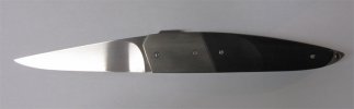

Hi There everyone - I'm new here and relatively new to knifemaking too, especially folders. I'm currently working on my second folder. As a result of being shown by someone who uses this method, I've used a floating pin (basically a piece of 5mm stainless shafting) for the pivot pin and I'm having difficulty getting the blade to run as firmly along its travel as I would like. This is no doubt as a result of the fact that this method does not allow you to remove ANY play because the pin cannot tighten + the fact that the spacer/stop pin have to be EXACTLY the same thickness as the blade (I've milled the titanium to make washers). Are there any folks out there who have tried this method as well as a screw/threaded tightenable pin and can give feedback? Will post photo as soon as I'm done working on it.

Hi guys,
sorry for any confusion as a result of my bad explanation. Ed, I get what you are referring to but Salem is right. I'm talking more about the pivot pin. The problems you have listed with the milling of the washers ARE enough to drive a man to drink *sips beer.
Brian - what you have just pointed out is one of my main problems with this method. It is really lacking in overall strength in my opinion as a result of not having anything to stop the liners from "spreading open".
Salem. The second option you have mentioned is what I do - sort of. I don't mill ALL over the liner.
Have taken a couple of pretty ugly photos for you guys. But hey its after 11pm in South Africa and I'm tired:yawn:

The lines remind me a bit of a Jurgen Steinau... I'm kind of scratching my head over the design somewhat, I can see however that you have some grinding, milling, and hand sanding skill.
It is possible to make fine adjustments to the length of your pin by lapping in against sandpaper on a surface plate while holding it square by running it in a hole in a block. You can lap off a few thou in a hurry if the pin isn't hardened. If the pin is hardened you can do a variation of this on your knife grinder.
Salem - thanks! I like Jurgens Knives. Lemme know what about the design has you scratchin - I'm keen for feedback where I can get it.
Thanks for the compliments. In terms of milling, I do everything on an old emco unimat with it's little milling head. Tricky to get it right since everything on there is about one tenth of the size I would like :)
Nathan - length of the pin is immaterial. It just rests there, the bolsters stop it from falling out. It isn't being clamped or anything and doesn't effect the fit at all.
It boils down to you must have something keeping the knife from spreading at the pivot.
A typical pivot with a screw, a peened pin, etc...
Your liner is pushing on the blade, and spreading the knife open, with nothing to counter it.
From your pictures, it looks like the holes in the blade and liners are not precision surfaces, and neither is your pin. ?
James, I was just scratching my head because I didn't get how it worked. I see now that what kind of looks like the lock bar in the first pic is actually the spacer/stop on the spine. And I get that the pivot is kept by the bolsters, I hadn't seen it done this way before. So it seems that you have not yet cut the lock, or that it will be a slip joint? It seems like Brian is right on with the need to fasten the liners together in the front somehow. Just a thought, but maybe if you put a threaded stop pin in, like a sebenza? That would hold the liners together up front, your stop pin would still have to be exact length.

Thanks for the feedback guys - you are right. I want to have the pin hidden behind the bolsters though. Do you know of any such screw type pivots which are low enough in profile to be hidden behind the bolsters?
Joe-bob - not sure what you mean, but they're about as precise as I can get em with my current tools and knowhow.
Salem - It is a liner lock - lock is on opposite liner not shown in the picture.
