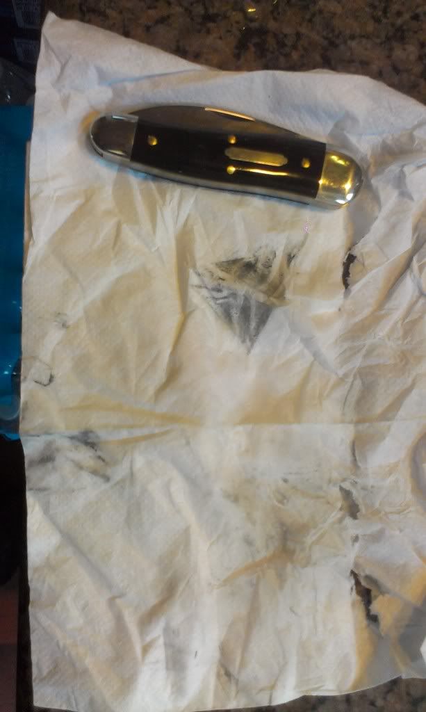

Joepa I just went ahead and flushed the joints on my new #57. I used straight wd40 sprayed into the pivots and worked them for a while. I used a napkin to rub the whole thing downside and out. I'm a little surprised at how clean it was going by what everyone says to expect.
That's all there was:
At first I thought that nothing changed, but now I can tell there is a difference in the pull. It's a little smoother (probably just the wd40) and the pull is markedly lighter. :( it's actually not that big a deal, but I liked it better before. I'm sure with a little use it would have ended up where it's at now, but yeah, I can kind of see why some of you like a heavy pull.

WD40 is somewhat of a pathetic lube for a slipjoint. You may try something with better lubricating properties.
Also, if you used a napkin inside there's a chance particles migrated into the joints.
I only use very high quality pipe cleaners to clean in the wells and pivots.
Oiling with a good lube will never lighten the pulls in a bad way. It may cause less friction but it will not decrease spring pressure :)

I find WD-40 to be a fair cleaner for removing gunk. But, after the cleaning , I use some actual oil to lubricate it.
The actual stuff I use for tough cases is "Rock n' Roll Gold", a lubricant for bicycle chains. It's Teflon and wax diluted with Hexane. The Hexane cleans out the gunky and the Teflon and bit of wax lubricate like a banshee.

I 2nd what Frank R said .WD40 is a poor lube. Use any of the lubes recommended in this thread to lube(I use Triflow ) your knife after the WD40 flush.That is a beautiful 57 Strigamort!
I used some soap and water and worked the blades a bit. I then dried it with cool air from a hair dryer. I then lubed it with mineral oil, worked the blades and cleaned off a bit of gunk. I think it may have smoothed things out a bit.
