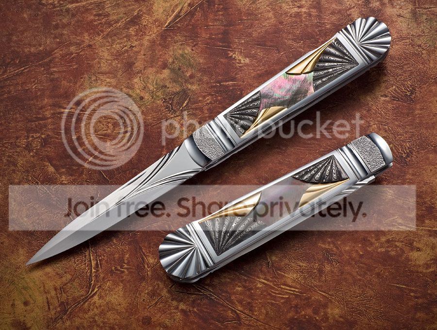

A bunch of fluting on this one, concave and convex.
Wolfe
The convexe fluting in a "fan" array are incredible, i can't visualize the technique involved short of using those die sinker files!!! :thumbup:

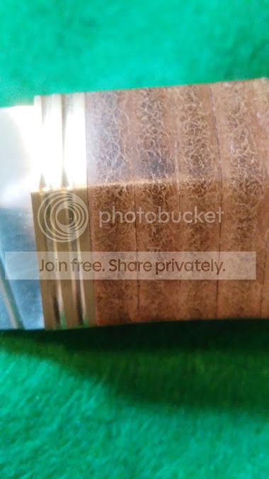

Well, I feel pretty silly following Wolfe...but since most of us could sell our souls and not be half as good as he is, I thought I'd post some shots showing this technique as done by a mere mortal. :)
