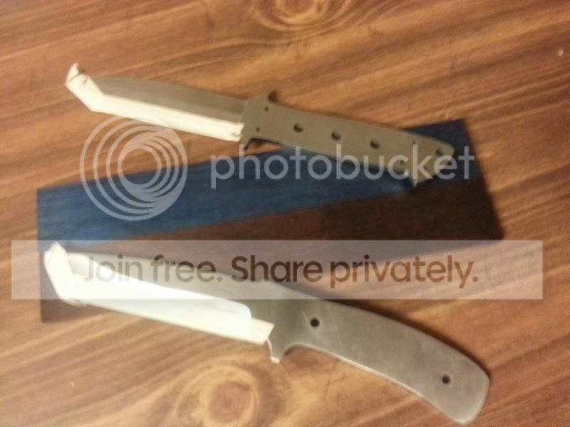

The reason I'm writing is this: a good friend of mine found out I wanted to get into knife making. Turns out he already had a couple of blanks he'd purchased awhile back but hasn't done anything with. He gave them to me to finish as I please with only 2 stipulations: 1 has to have a "more natural" handle and one with "something just a little different but not crazy." I'm thinking of using this (or something similar) for the "more natural" and this for the "something different" (he told me his favorite color is blue). I'll get pictures of the blanks up soon as I can. I left them at my parents house since I'll be setting up my shop there (I live in a small cabin in the woods with my wife a 9 month old son, no room here).

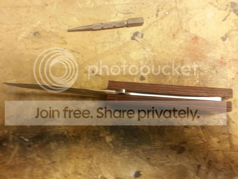

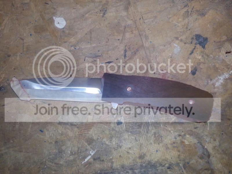

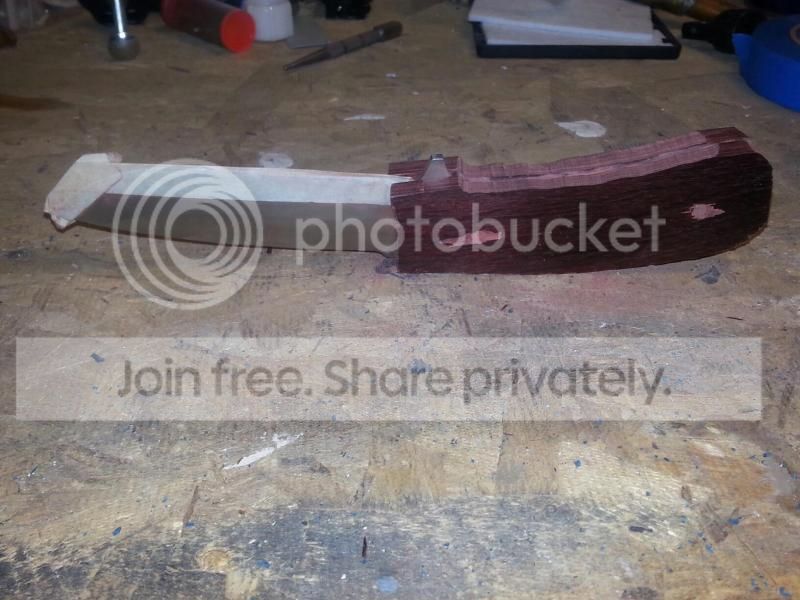

Here's a few progress pics. Haven't had a lot of time to spend on these. If I'm not allowed to post these or they need moved please feel free to lock/move this thread and let me know. Thanks! Sorry for the crappy cell pics.
It seems you've already pinned it on...so my advice for next time is to trace the handle onto the scales and get them mostly to shape BEFORE you attach them. Also finish the front portion(part that meets the ricasso) as much as you can beforehand also because, as your probably finding out, its very hard to work that are without damaging the blade.
Keep at it:)
Keep at it:)
Thanks for the advice man. Truly. :)
I pinned them on but haven't adhered them and can still remove them. I don't have a bandsaw or drill press. Used a hand drill and was trying to get a rough shape without having to use JUST the files I have (dad has about 20 files I am using...for free :)).
I will be removing them again to get a better, more refined shape by hand.
