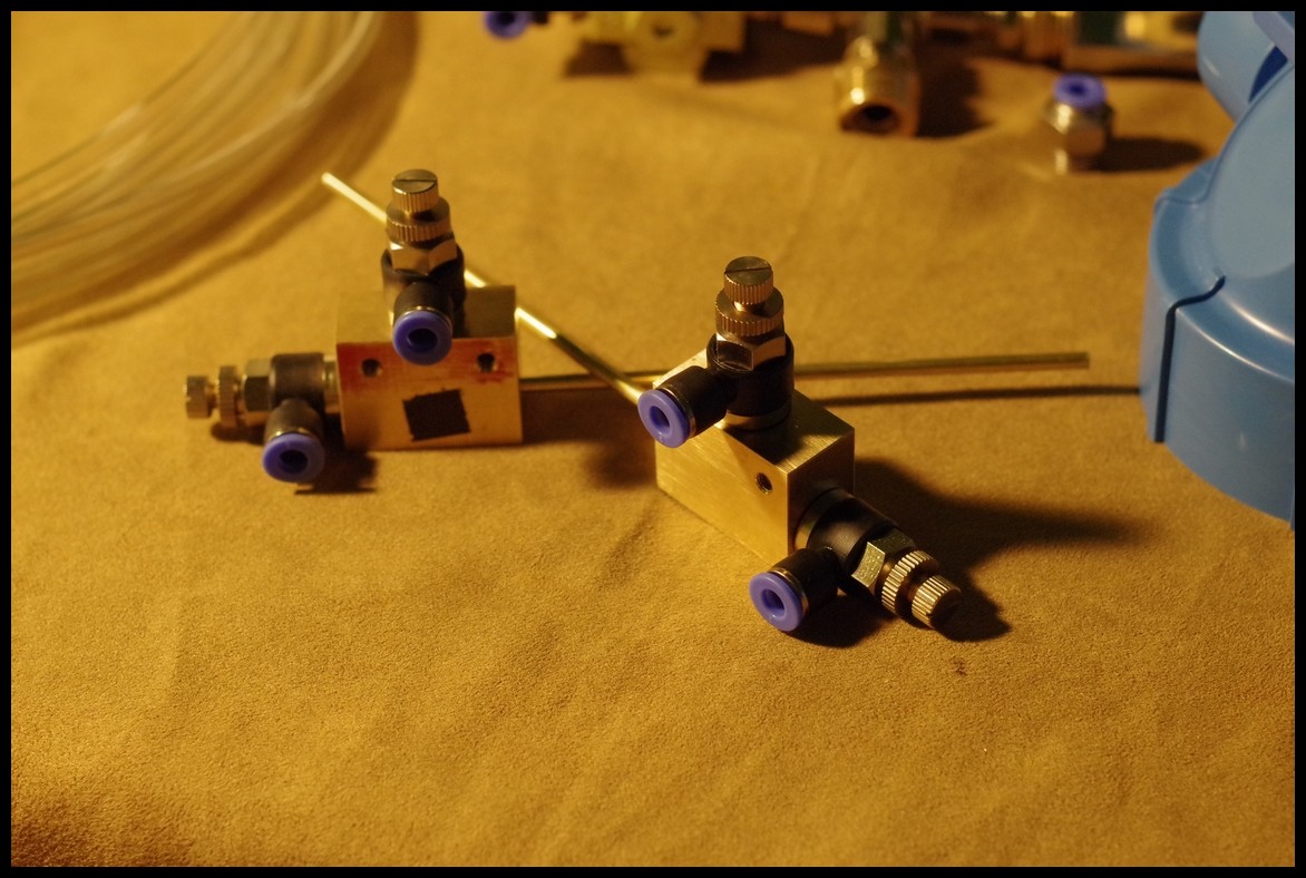

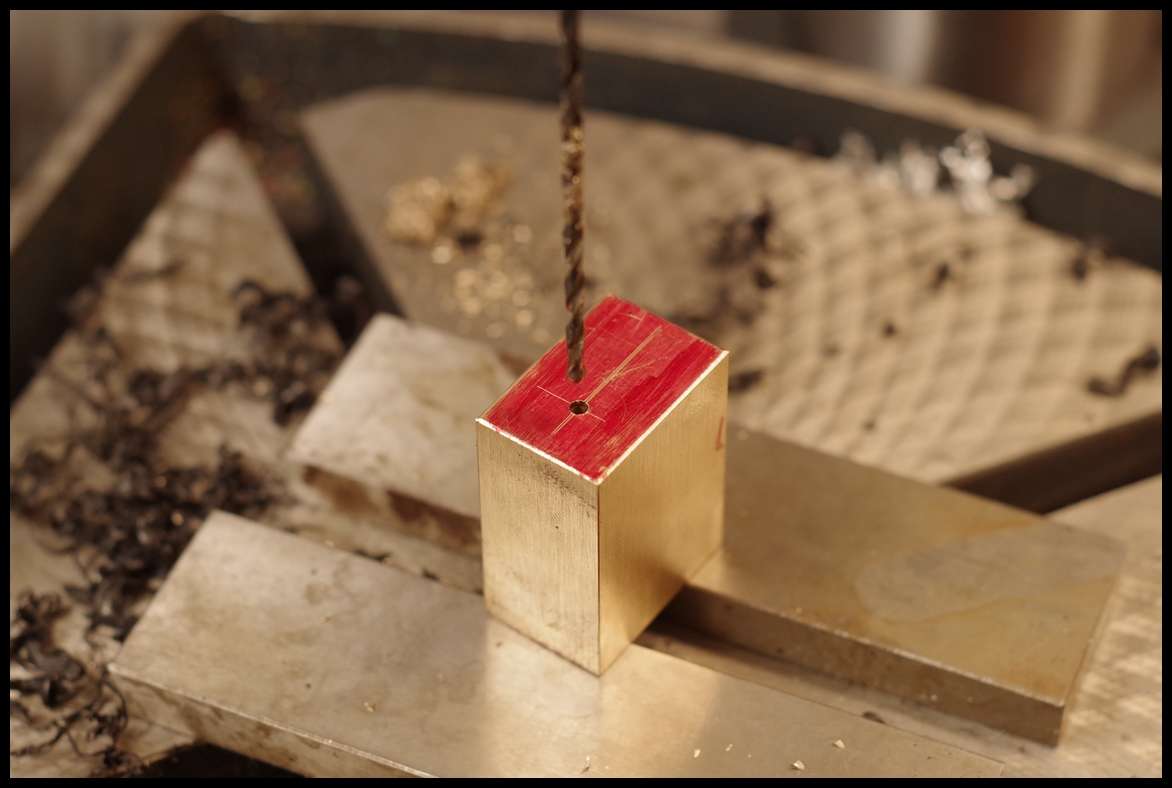

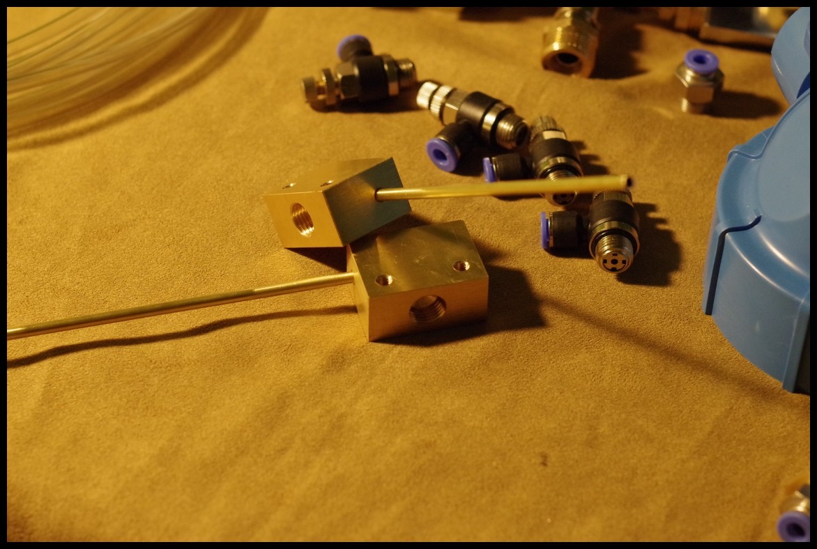

As from some time I got surface grinder, there will be awesome to get some coolant.
But as all we know a flood type and classic mister make a big mess around and in some time all stuff in workshop have thin layer of dry coolant residue on them.
I asked myself " why to not make a good fogless mister by myself? "
Small search on Practical Machinist forum resulted in design of fogless mister like Fogbuster.
After that we need a coolant right ?
Here in Poland I got a Silvergrind 3001 designed specifically for grinding and precision grinding. ( 5% emulsion)
But in US you have Cimtech M26 etc. good coolants.
When using this type of mister on lathe or milling maschine, we use a very small amount of coolant.
But for grinding we need this more like 100-300ml per hour, to get good cooling of hardened blank, keep belt/wheel clean, and also less friction result in less heat. Belts also should last for longer.
In 2 days I start to make first fogless misters and will report progress of work on 2 systems, 1 for SG and 2nd for belt grinder.
View attachment Fogless mister v1.pdf
Cheers,
Konrad
