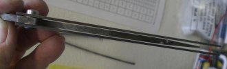

Got her smooth as butter, perfectly centered blade, no side play and thin washers as well...
Need to get a finish put on but it's getting close.
