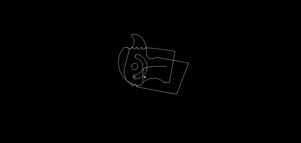

Hay Guys,
I have made about 100 folders now, and now that they have been around a couple years every once in a while Ill get one back for repair or its just worn out a bit. I have been working on new designs and trying to make the existing designs better. I hope some one can give me some help on this to make my lockup design a little better.
I have had 2 flippers come back that had a little bit of vertical blade play when open. I am 100% certain it is not lock rock. so lets not get into that. it seems with the internal stop pin set up Im using causes any slight play in the pivot, translates right to the blade instead of being absorbed into the lock by camming action. so if the pivot hole is .250 and the pivot is .249 I get that .001 transferred all the way down the blade to the tip 4" later and it ends up being several thousandths.

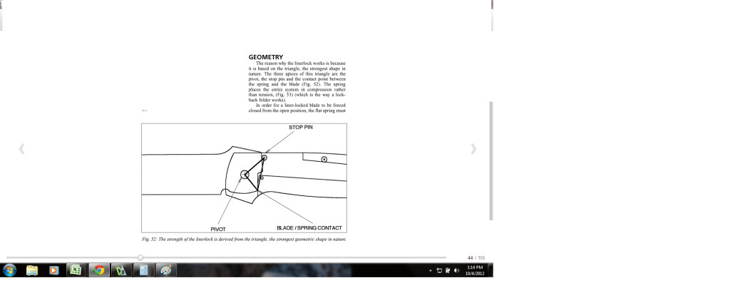

I have Bob Ts book and know about lockup geometry for the most part. I still have much to learn.

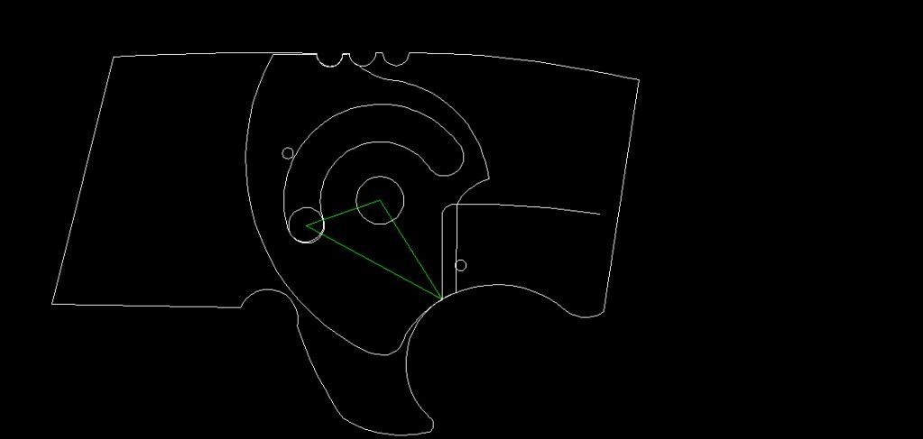

Here is a simple drawing of how my lock is now.
The green triangle in the open position should give you a reference as to where the camming action is taking place. it seems that I cant get the lockface of the frame below the center line of the stop pin to create enough camming action to take up and slack in the system. So basically there is not a lot of forgiveness to this setup currently.

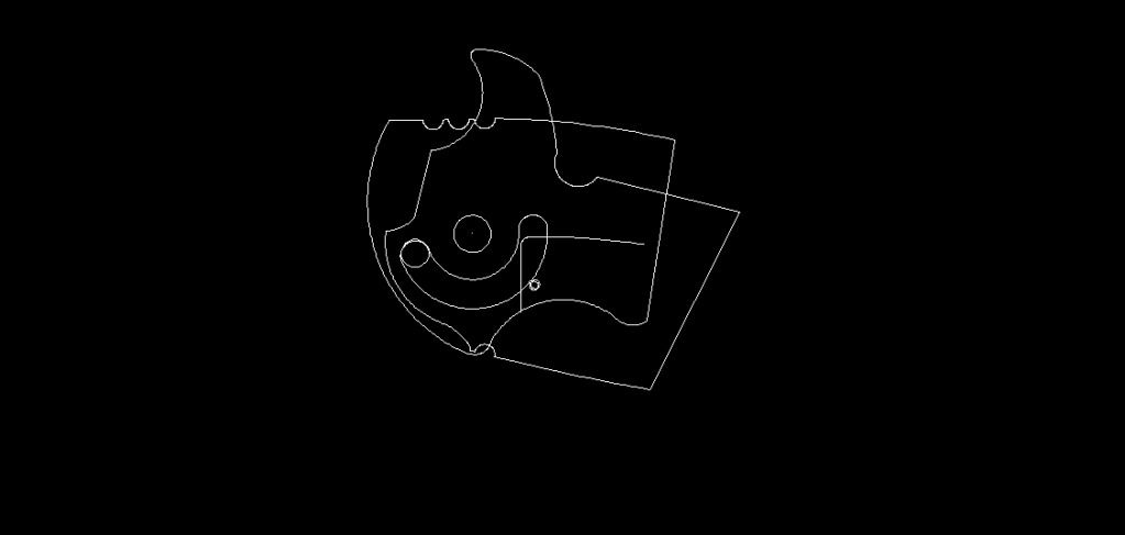

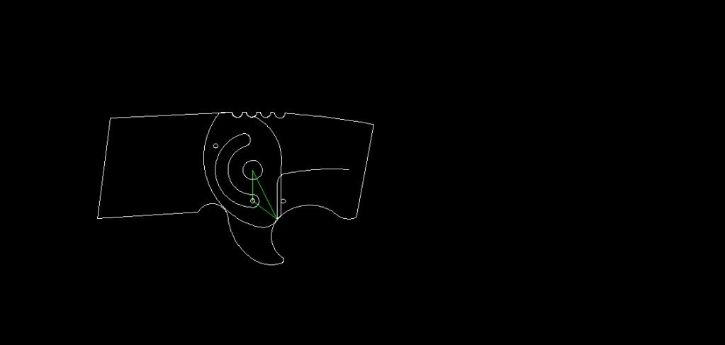

Here is what I just drew up in hopes of moving the triangle to better account for inconsistency and have more forgiveness.
I didnt have to do much but rotate the whole stop pin track a bit and adjust the blade shape to suit.
Any body have any other recommendations? besides switching to a external stop pin as I rather like the ease of making an internal compared to an external.
I have WJ waiting on new drawings.
Thanks guys! God bless

I believe it was nailed when Carl said it was all about the triangle. The problem isnt so much the tolerances as it is the meeting of the pivot, stop pin, and lockface.

The position of your stop pin is irrelevant.
Providing the blades contact on the pin is correct, it's actual location means VERY little.
What is relevant is where the lock contact is.
I don't mean the bottom .06 to .100 either, you already have that covered.
I mean the actual geometry of the location.
Providing the locking point is the same in drawing one as drawing two, you will see no difference in lockup.
None.
External stop pin, or the "perfect" equilateral triangle? No difference unless you move that contact point.
Pressure applied to the spine of the blade, or against the lock is applied in a line perpendicular to the line between pivot, and contact point.
So, as you can see from my edit of your drawing, you are pushing up on the lockbar, rather than back, or along the length of the lockbar.
There is very little strength this way, and a lot of room for play on a 2.8" long bar.
attachment.php
That contact point needs to me moved as far to left and down as possible, to direct that force ALONG the lockbar.
Get your force moving in the right direction, and the pivot tolerance nice and tight, and your problems will disappear.

I believe he is mistaken on the equilateral triangle thing.
Blasphemy, I know.
I was a firm believer, and took it as gospel until I really started thinking about it, made some knives, did some math, modeled it, and beat the hell out of some knives.
There are many factors, and stop pins are a big concern, but once you have some basic rules figured out, the actual location of the stop pin, in the scheme of the rotation of its location, is irrelevant.
What actually matters on stop pin location is that contact is made at the proper point on the pin, and that it is as far away from the pivot as is feasible.
Draw a line tangent to the stop pin, and through the pivots center.
That tangent point is where you need contact to happen.
And contact with an arc is better than contact with a point.
You get that automatically with an internal pin.
Once you have that part worked out, you can rotate that wherever you need it to be.

Thanks Brian....that makes perfect sense to me. I see your point on the equilateral triangle. It just seems like the greater the distance between stop pin and lock bar contact point....stronger.
