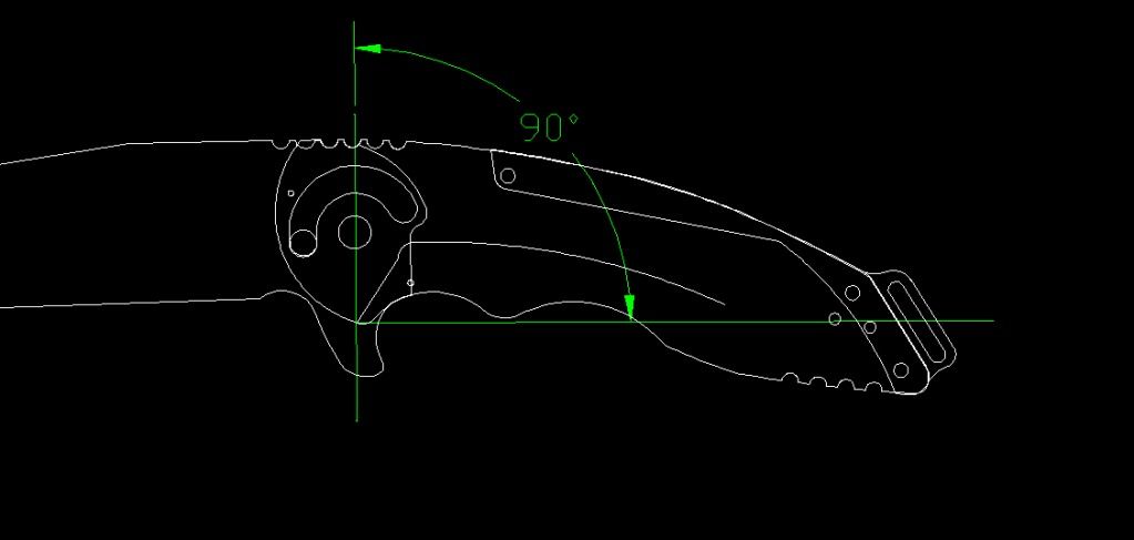

Oh hay Brian or anybody else for that matter.

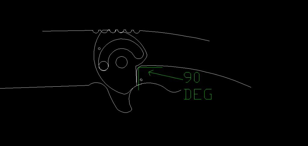

Let's talk about the angle of the lockface a little. I'm talking the angle relative to the bar its self. Do you usually stick to a 90 deg angle or have you noticed any differences with a more obtuse angle? Sorry hard to explain with out a pic. My lockbar has a curve though its length. I'm talking when the lock gar gets to the lockface that angle. Not the face of the lock but the angle of the bar.
Pics coming.
quick pic. Gotta run be back in a bit

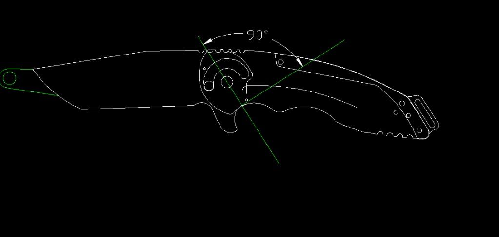

In that pic, you are 90 degs to the blade, not the bar. I shoot for 90 degs to the bar. So the blade wants to push the bar 'back', not 'down', or 'up'.

Brian
There is no one size fits all answer for this one Jake.
And your picture doesn't tell the whole story, since we don't see the whole lockbar, and therefore know where the axis if the lockbar is.
I shoot for the lockface being parallel to the lockbar axis, though this isn't always feasible.
This is tough on a curved lock, unless the lock curves back before it ends.
Everything we do is a tradeoff, we can almost never have perfect geometry.
But by understanding the forces at work, and the physics behind them, we can engineer for success.
Give a little here, take a little there in order to minimize the effects of our less than perfect geometry.
Lets assume your lockbar curves like that it's entire length.
The "Perfect" geometry for that might actually put the point of contact in FRONT of the pivot!
And the angle you highlighted would become obtuse, rather than the 90* shown as well.
As you can see, this usually won't work in reality.
The "perfect" geometry for a lock has the lockface as a radial line passing through the pivot, AND has the axis of the lockbar parallel to that.
Once we start moving away from this perfection, we just have to start balancing the two.
Always draw a line through the pivot to the contact point on the lock, then draw a 90* line from that point.
You can then see where the force is pushing when pressing on the spine of the knife.
From there you can start making judgements on everything else.

Thanks Brian, that helps a bunch! Was never good at geometry in school:) but you put in a very easy to understand way. It seems as though I need to kick the lock face out towards the pivot a bit to make the force push back instead of up.
I'll post a pic later and hopfully I understoon what yall are talking about.
I'll just post up the whole knife for reference also. Lock bar is curved the whole way.
Yep, you are understanding!
Except that whole lockface would also need to move to the left so the lockface is in line with the pivot.
Remember, these are Ideals, not realities.
Reality dictates that you make it the way you are...
Do what ever you need to do to get the lock face close to 90 deg.s with the bar and as close to the pivot as possible. Compromise, split the difference, meet in the middle, etc...
I learned liner locks while making around 300 latch release liner locking autos. PITA! :D
P.S. your original design is not bad at all. I would just tilt the lock face a bit closer to 90/w the bar and move it forward a bit.
awesome guys thanks for helping me understand that a bit better! I think with the new stop pin location a little further out and a little more tilt to the lockface I can start making it easier to make these things.
