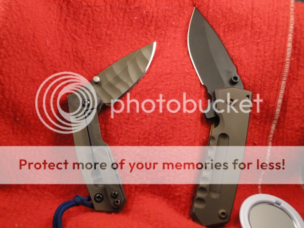

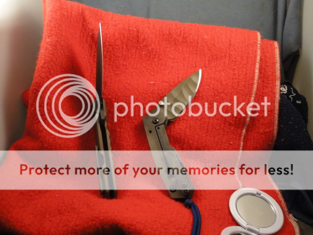

abuse these
crusader forge in 3 & 4 in. as suggested by lycosa.triple tempered s30 which easily outperforms all factory s30 offerings. custom knives in excess of your parameters. however probably the strongest folder in the world.
dennis
abuse these
dennis
Dennis - Those are some fantastic looking folders. What are the specs on those? S30V, Ti, Blade Length? OAL? I am impressed.
revdevil i'll give all the specs tomorrow. can tell you the 4 in. is almost 11 oz.all tit. is machined including clips.this is probably only folder in world can be thrown at brick wall ---still like silk.
dennis
dennis
can you also get us a pic of the lockup thanks.
