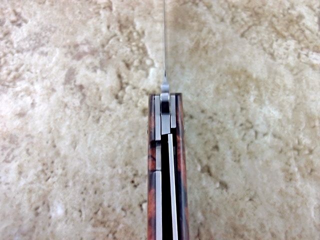

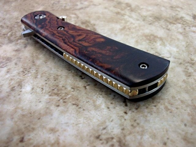

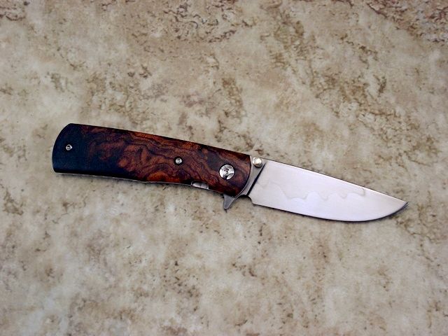

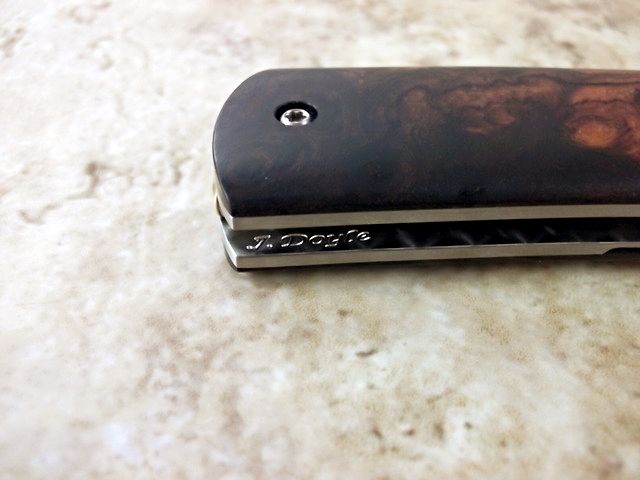

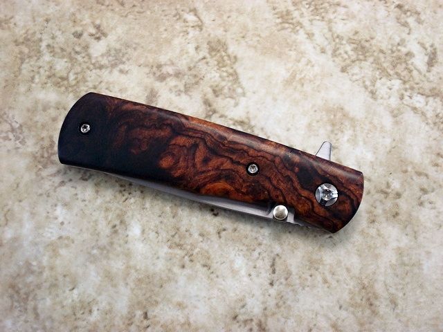

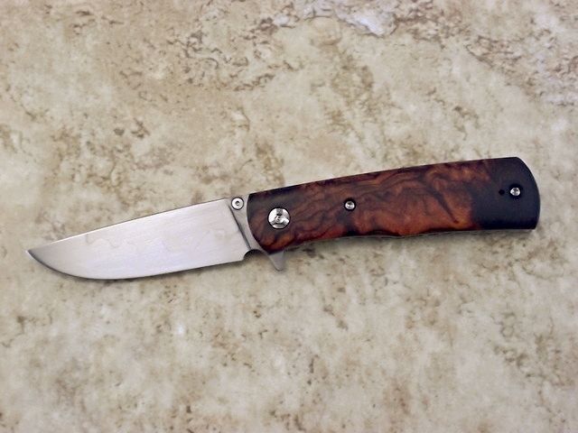

And a lefty, no less! I spent a LOT of time thinking and double checking and triple checking to make sure everything that needed to be switched for a left handed person went on the proper side. I think I got it right....or left, rather. :) Still need to finish up the pocket clip, which I will do tomorrow.
Specs:
7 1/4" open, 3 1/4" blade, 4 1/4" closed
W2 steel blade with hamon, .115" thick at the plunge line, full distal taper
Rounded spine
Rounded, filed thumb grip
.060" titanium jeweled liners
Desert Ironwood scales
Titanium pivot and handle screws
Bronze backspacer with lanyard pin
Bronze thumb stud
All comments and discussion welcome.
just perfect... other than everything being on the wrong side of course, lol. great looking knife
I dont typically like folders. I dont make them either. This is one that I would be proud to carry. It is a very sleek folder, and the wood really sets it off. I like it very much!
Thank you all for the comments. I appreciate it.
And yes, to the question about tip up carry....it is indeed.
In addition to the thumbstud, the lock is positioned to be most effectively closed with the left hand.
