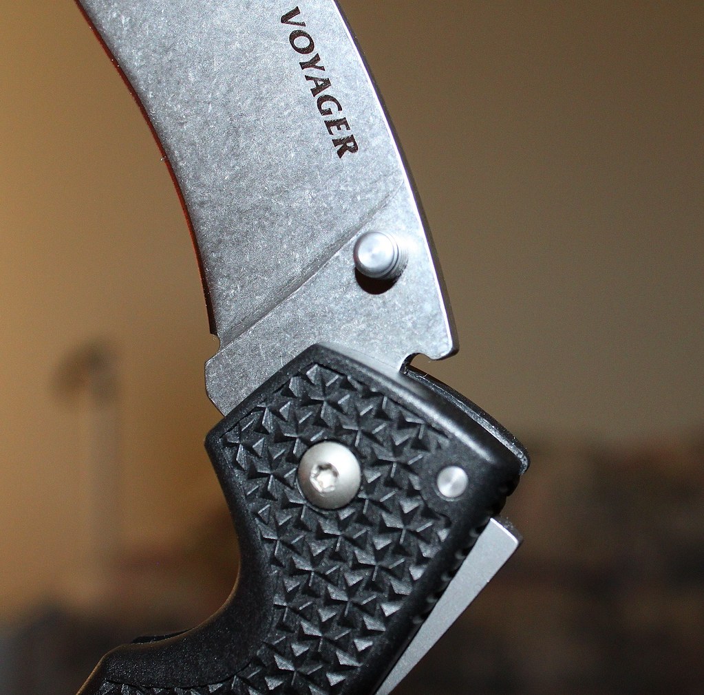

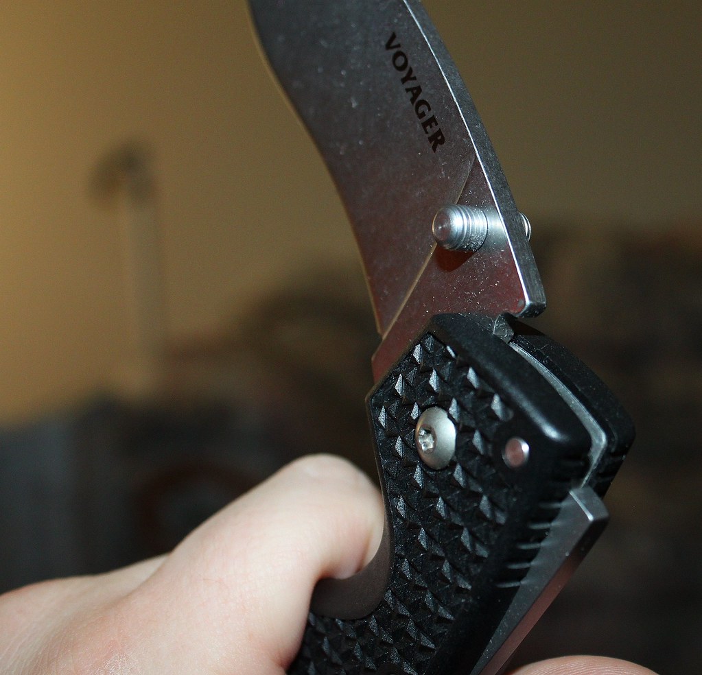

As far as a curved/shoulder section of the blade tang - I thought all Tri-Ad knives have it, it's always been on their diagram :confused: here is one of the $38 Voyagers - lock-up is as perfect as you could ever hope for in a folder at any price.

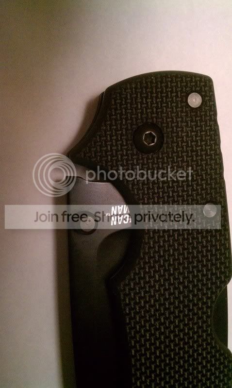

My American Lawman also has that small jump on the tang. But it doesn't do anything. Its not even a curved radius it is a jog with straight lines. There is a line on the tang where the paint is worn where it makes contact with the stop pin over just one small area. There is a matching mark on the stop pin and I can look in the knife and the 'tab' sticking out extends over the stop pin and doesn't touch anything. If that jog doesn't increase the contact patch with the stop pin then it doesn't have any benefit. I was talking about an actual half circle that wraps all the way around the stop pin.
I wasn't saying any other lock is 'better' that the Triad. Just that others have features I like better. As an engineer I like to have more reasoning than "just because". If a lock uses a piece of metal to bridge a gap between tang and stop pin that gets compressed and the forces are transferred through it, I don't see how one lock can be significantly stronger than another. They use the same principles just a slightly different way of implementing them. I have yet to read an explanation why the Triad will be significantly stronger than the other locks that are out there. I don't need an explanation because I can see how the different locks work, but if it is so much stronger and better than everything else, then someone who believes that must have a logical explanation why. Sure if one lock uses stronger or thicker materials it will be stronger, but many locks can be over built to make them stronger. Just to be clear, I haven't said anything bad about the Triad lock.
Also, the amount of moving parts has nothing to do with strength. An argument can be made that less moving parts may be more reliable, but there is no relation to how strong it is.

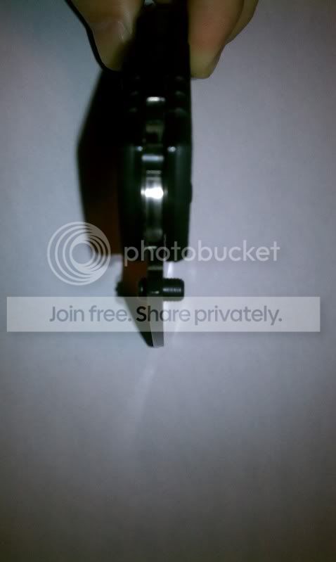

I see what you are saying. I took a good look at my lawman, and I can see where the coating is missing inside the radius in the tang where the stop pin contacts it. Just to be clear, there is nearly a full half circle what wraps around the stop pin on my lawman's tang.
Also, I don't think that any one can argue that a fixed blade is not stronger than a folding knife.
There is an actual half circle that wraps around the stop pin. For the Axis lock does the stop pin do anything when there is negative pressure or only positive pressure? I think that might be the main difference besides springs and how robust the parts are in general.

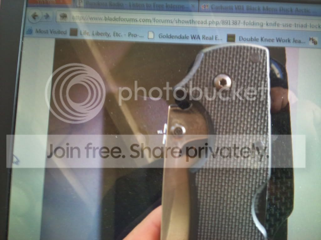

Well the Lawman definitely does not have that. The picture you posted looks just like the Lawman from what is visible so I assumed it was the same. The AXIS isn't the only lock I am talking about, but no the stop pin does not handle negative pressure. That is left to the lockbar that slides and engages the blade tang. It is essentially a sliding stop pin and it transfers forces to the liners, just like a stop pin does.

Edit: Here is a (somewhat lousy phone) pic of the tang. No radius, just a tab that jogs out and is more straight lines than curves.
Here is where the tang contacts the stop pin and has knocked paint off. Just a narrow line from the small contact patch about one half of a mm wide. It is the line about halfway between the thumbstud and where the handle starts.
Tried to get some pics to show it better

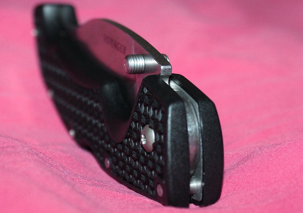

Main difference then is with negative pressure the Tri-Ad basically has another large pin that needs to be defeated, thanks to the lockbar, and it's another pin that is stuck in place. Initial pressure is distributed in more than one location on the handle/liners. From an engineering perspective it should be considered better even if viewed as overboard for some people's taste - it's definitely not redundant and doesn't have a ridiculous mark-up like trying to get the latest, greatest blade steel.
Actually the only way the other pin would come into play is if the stop pin was defeated. The lockbar pivot 'hole' is elongated so the lockbar can slide back and forth. Forces only go to the stop pin based on the pic in the other thread going about the Triad lock. When locked open there is still space between the pivot pin and the lockbar.
