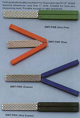

Like this one?
It would be cool if it was real Spyderfly-ish. Flippin yer sharpener. :rolleyes:
Like that but not quite.
See the one with the blue handle? Now imagine the handles that are blue are the sharpeneing stones, and the stone part is really the handle. (Actually in my idea the handle swing out to the side so you are not inline with the center part of the "V".)
