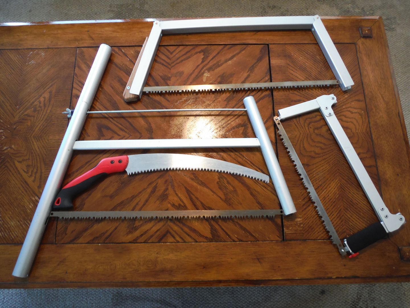

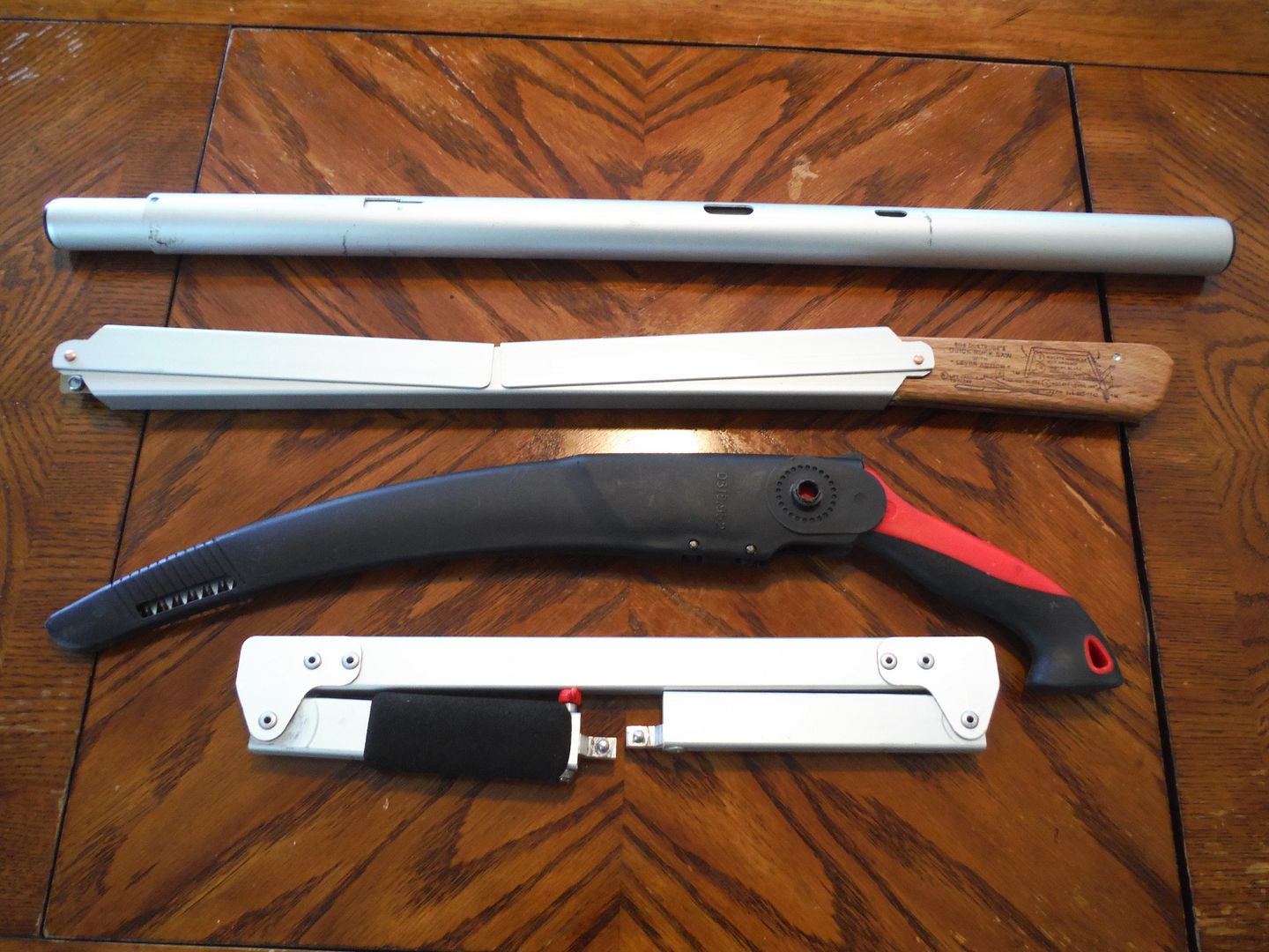

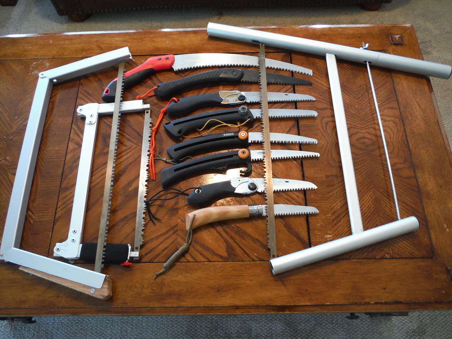

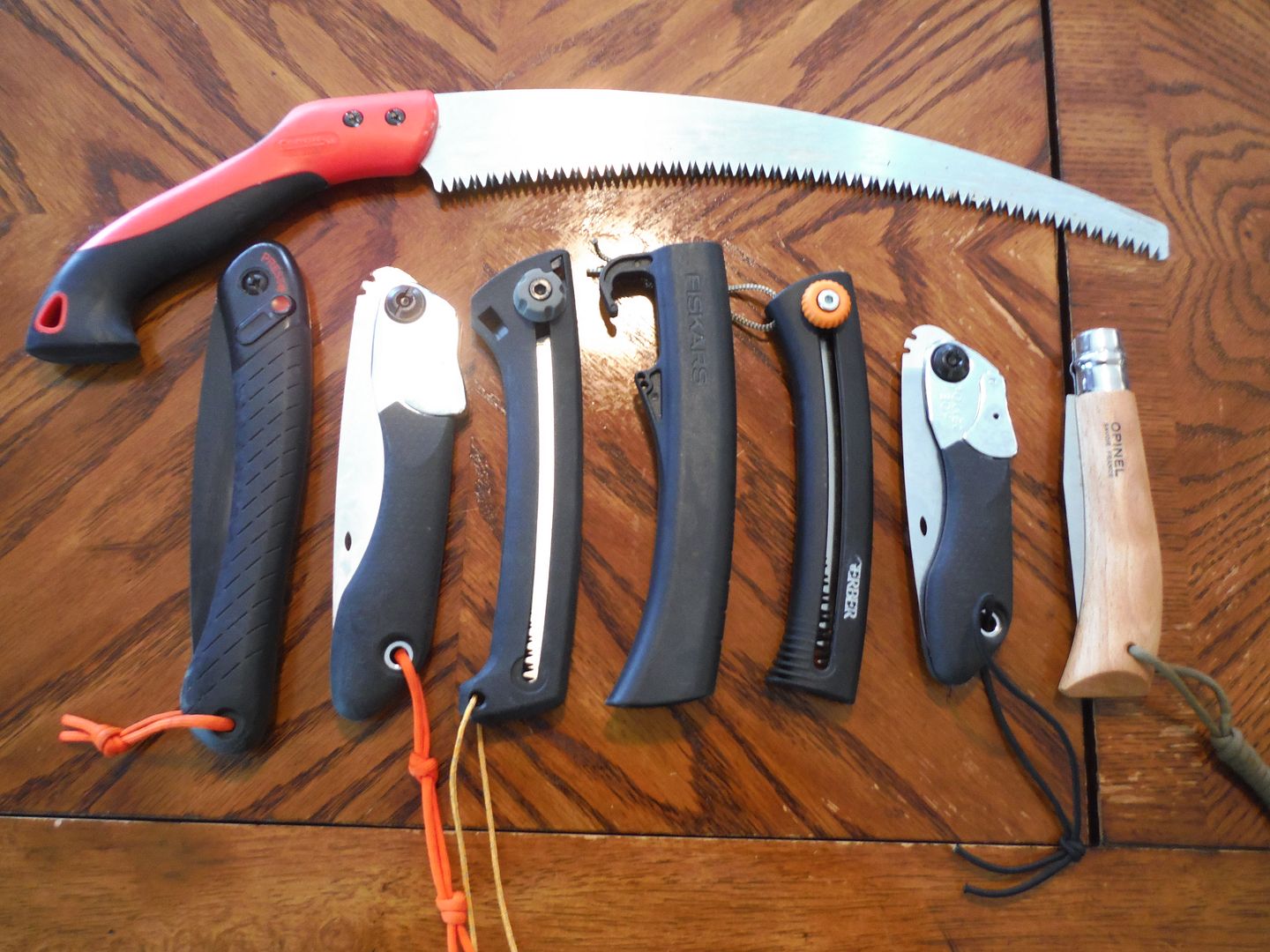

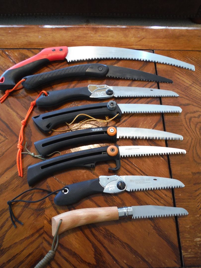

I’m really disappointed Sawvivor went boots-ups (last I heard). I have the 15” model and it is really one of the best, packable buck saws. I actually prefer it over a Sven saw I had many moons ago. The biggest bonus is that it houses two blades, so I always have a backup. It’s also pretty light and just plain simple.
I have an older buck saw, the Trailblazer, and it's a tube-constructed one. The 24” blade is nice, but it requires special plastic caps so cheap hardware-store blades won’t work off the shelf. It’s your standard bucksaw construction when put together, but it’s heavy and kind of a PITA to set up. On the flip side, my new Dustrude Quick Bucksaw is probably the best packable, large bucksaw on the market. Perfectly simple and fast to put into operation and collapse. The 24” blades are standard (you just have to swap the hardware) and it folds up tight and svelte. It’s also one of the lighter saws and just a little bit of sawing I’ve done, it works like a charm.
Weights for reference:
Tube-designed bucksaw (Trailblazer): 23oz
Dustrude’s Quick Bucksaw: 15.8oz
Sawvivor, 15” (two blades): 10.1oz
Corona 14” fixed-blade saw: 13.5oz (that’s with the sheath)
Silky 170: 7.6oz
Bahco: 6.4oz
Silky 130: 6.0oz
Larger Gerber: 4.8oz
Fiskars: 4.0oz
Lightweight Gerber: 3.4oz
Opinal: 4.2oz
