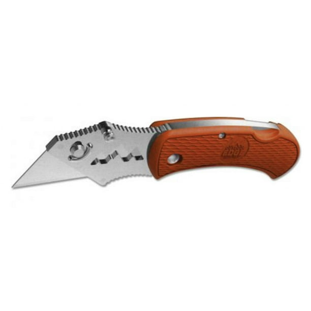

I use utility knives every day for work....have em all Gerber, browning, kobalt, Milwaukee and so on....the one I'm stuck on and can't forsee straying from is outdoor edge's b.o.a....
That was a good recommendation, thanks. I ordered two, and they immediately kicked the Milwaukees out of my tool boxes. True one-handed opening, nice lock back, light weight, great jimping. The opening is not smooth like an upscale folder but it works fine. The blade moves around a bit like all my other folding utes. All told, a significant upgrade, especially being able to thumb it open with one hand, rather than go through Milwaukee's press-button-gravity-drop-flip-around-flick maneuver.
