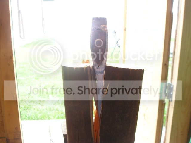

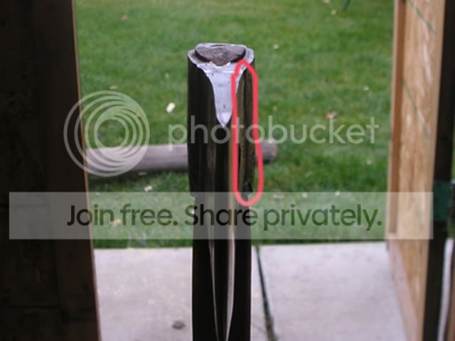

so first let me say I came to mostly the same conslusion as Brian, polished is awesome.:thumbup:

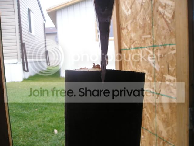

First off I wanted to get some shots of the edge going into the wood, now with this wood I couldnt get the axe to baton, it was too dry so I just gave it a wack into to the wood.

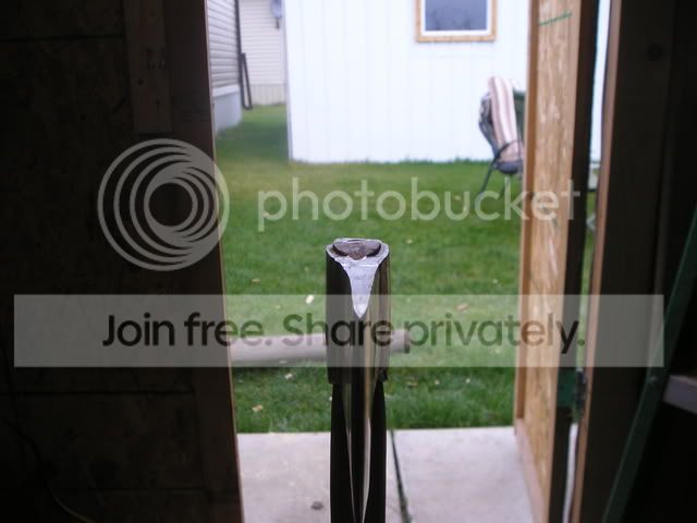

Then a little bit harder, you can see the side of the eye are where this axe has alot of splitting power, one small whack can clean through a round of wood, the face geometry of the wetterlings works really well for splitting, and chopping.

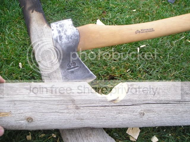

Here is just some quick chopping, this was after 4, moderate shops.

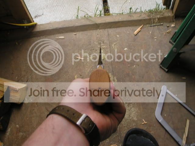

Now some face and head shots.

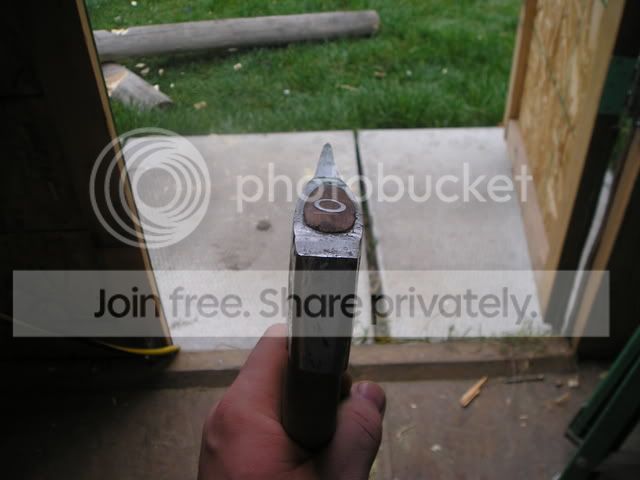

And finally a handle shot.
So, in short I havent tried a S&N nor a GB, but I've exactly what I want out of my wetterlings, it works amazingly.
Pick on up, I urge you too!

The need to baton is really dictated by the wood. Some wood splits rather easy, and I would advise just splitting it. If you are having trouble getting deep penetration, that is when you should try the other technique. There is absolutely no reason for it here.
Now, please take the rest of my comments as just my observation. It is just that; my opinion and observation. I don't want to come off as negative.
First, I like the head geometry of that one better than the GB.
Next, you will have to remember that as Robin Wood pointed out in my thread, I am talking about VERY marginal increases in performance here. I might take the right situation to even make the performance difference noticeable. For example, if you did the work I am about to suggest, I don't think you would notice it in your particular situation. But here goes.
That area, right there is the circle still has quite a transition. In fact, you can see it by the vertical line. The good news is, that it wouldn't be too tough to work out. The curvature there is good, and not nearly as steep as the GB. Look at that line, and then compare it to this:
Anyway, that is my nit-picky commentary :D I would not put that axe aside, but I don't think it would be my first choice either. But, like knives, kits and various other things, there is too much personal preference to have one person's opinion matter too much :D
I can tell you like your axes. If I got enough axe people seriously interested, you might be able to twist my arm into passing my modded one around.
B
Yeah, I agree %100, that is a friction area for sure. And another thing you're going to see with wetterligns is that they come in so many different shapes, it can get quite annoying. I know the first wetterlings I bought was nowhere near the fit and finish of this axe, the handle is much better fitted and the head its self is in much better shape over all.
But you know what, the head on this one still isn't perfect in fact it would take some time and energy to get a noticeable improvment. But, one night off Ill go at it.
