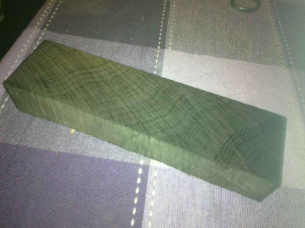

DI is so "common" these days. I'd go with the Koa. That Bog oak is the blandest piece of timber i've seen for a while. Great structurally, but for a knife handle? A nice piece of Bog Oak with plenty of Medullar rays and a bit of movement in the grain, with perhaps a touch of lightening in the tone and then you've got a winner.
Maybe something like this? Please note this was a mobile phone pic (The table cloth is actually mauve) and The wood is actually Black not green and has the faintest tinge of orange/red in the top left corner
the sides of the block has parallel banding that does that 3D dancing in the light trick you get on tiger maple
