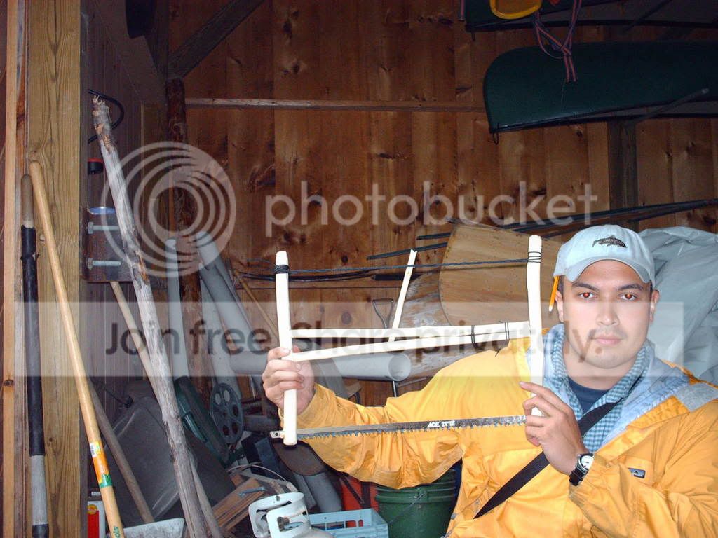

Bow Saw
I'll take some more bushcrafty photos this week. I'll be up in the Adirondacks for a few days and will have plenty of dirt time.
kev, neat idea on the double mid-rail on that saw to keep the two sides parallel...
what did you use to cut the slots for the blade? or is it just split?
It was just split very carefully. I used a Fox River only to make this and I could have had an easier time if I had a SAK or Leatherman saw in conjunction with it.
nice. i once tried cutting the slots with the blade itself, but i had a tough time of it...crosscut blades don't do well as ripsaws...
so the hole were drilled with the tip of the knife too...tricky to make them deep enough without too much of a cone affect...
