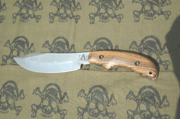

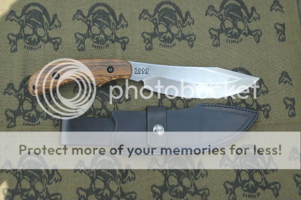

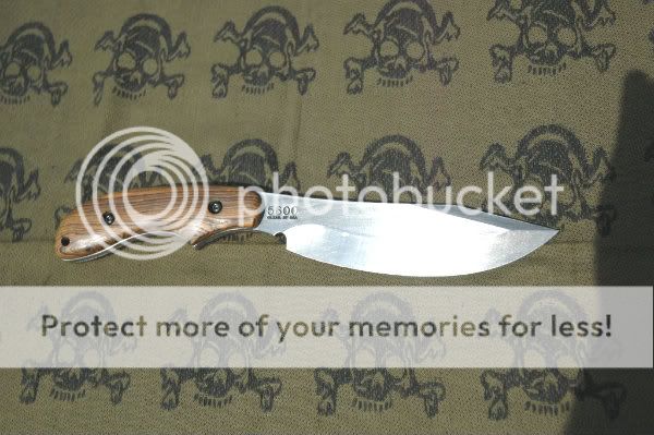

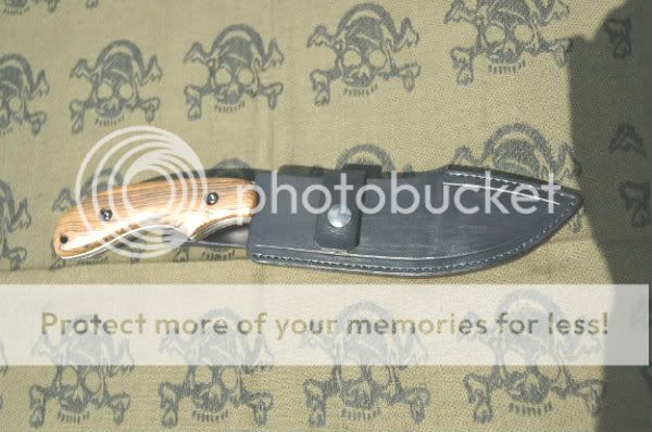

Here is a couple of pics of mine, she is stripped, forced patina, bocote grips by tommythewho, and a sheath I made. These are great blades if you are thinking of one, take the plunge.
