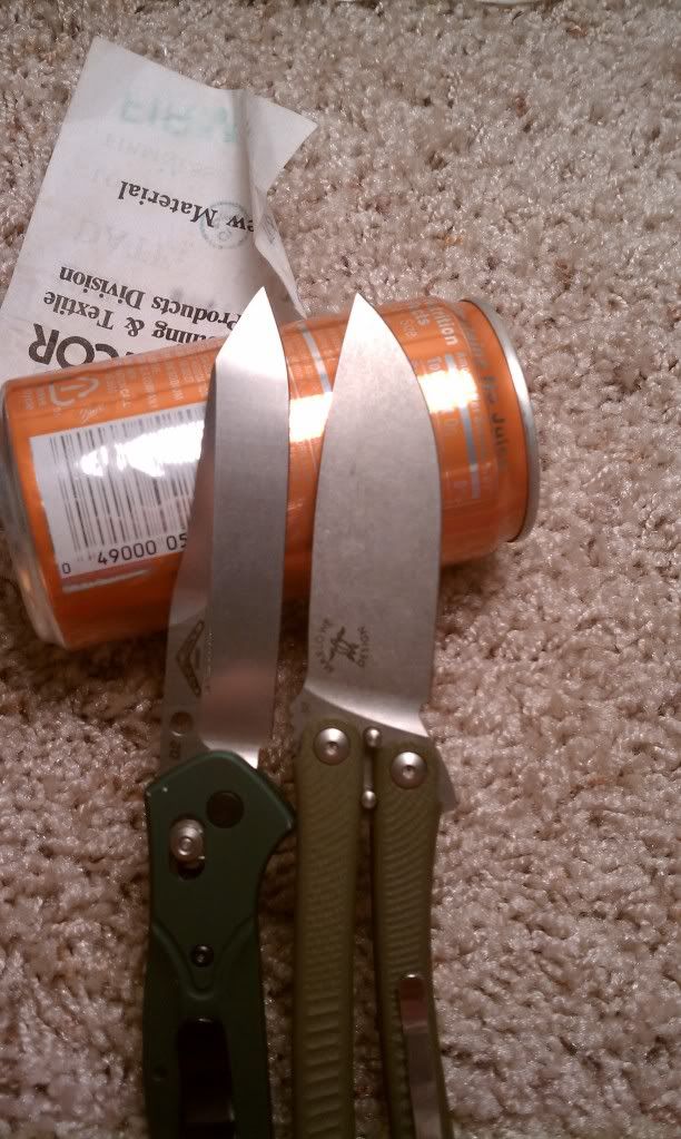

I was wondering what you guys use to patina your blades? i've got a bm d2 blade that i'd like to do this with but i'm not sure what to use or how long to soak it etc... thanks guys

D2 is as close to a stainless as you can get, and doesn't take a patina well at all. It will dis-color a bit. Its even hard to get an acid etch on it(most won't try).

I've never seen a good patina on D2 either. Most treat it as a stainless, since it almost is. Its about like the stainless ats-34 in regard to rusting.
I have seen some motted brownish colors in pics before, but never a D2 with a good solid patina.
Someone show us one:p

SpartanSaint ... I'm not seeing much patina there.

lol i realize its not much of a patina, it JUST came out of the box, but it is darker than the 940, my pictures don't do it justice. but i want to force a patina, and am getting great ideas! thanks fellas. another thing, should i try to dissemble for soaking? or..

I've seen some D2 get a little dark like that, but not quite as much as yours. I don't think you could get it much darker, or to show any colors.
