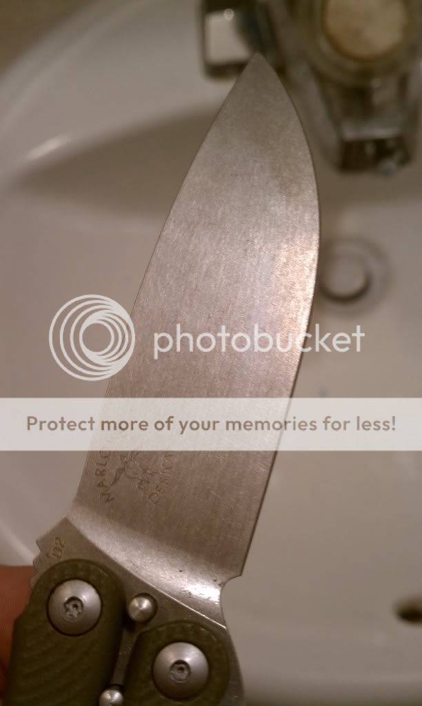

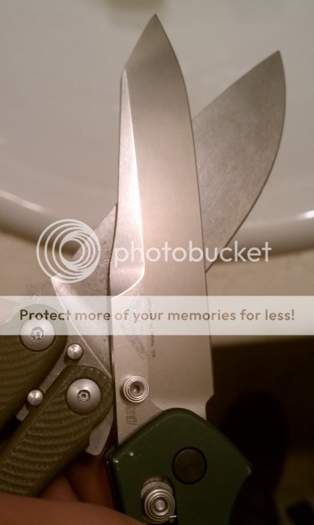

i swear that the 53 is much much darker than the 940...
i've been playing with it all day... mustard, lemon juice, apple sauce, ground beef [haha more food prep than patina forcing but hey, couldn't hurt my efforts could it?] and i feel like i've gotten a LITTLE more color but not much
