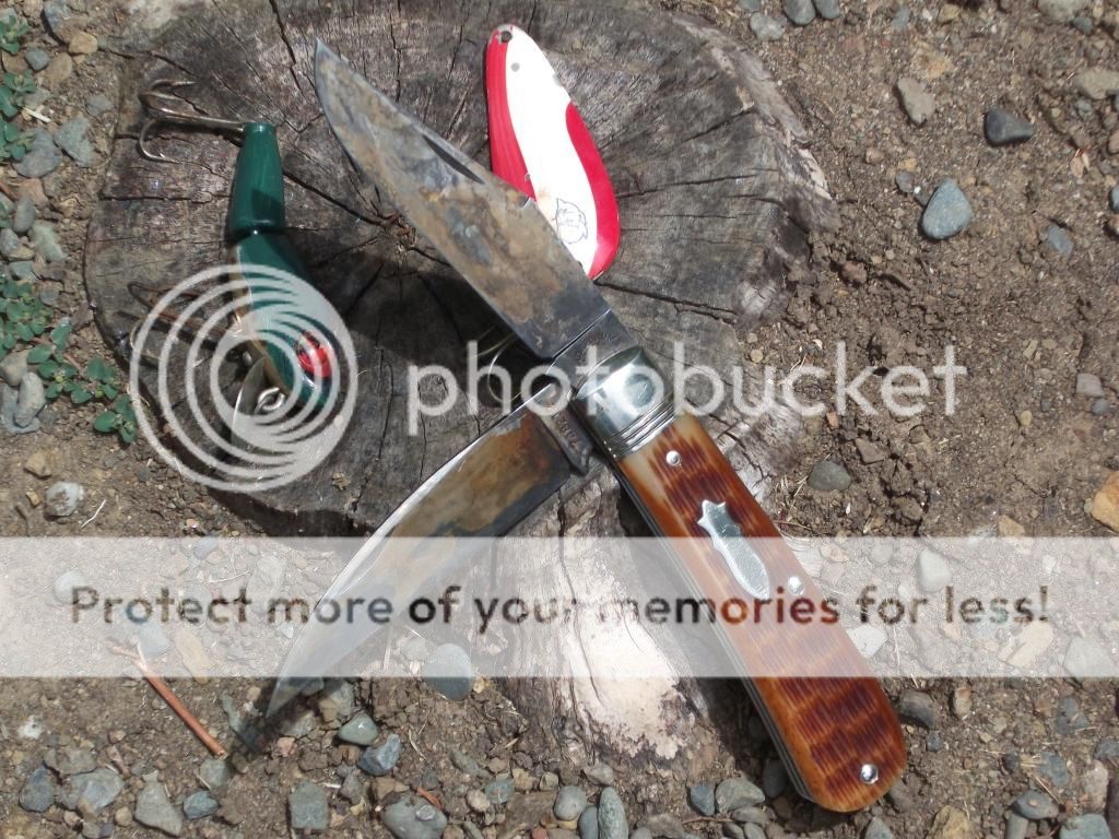

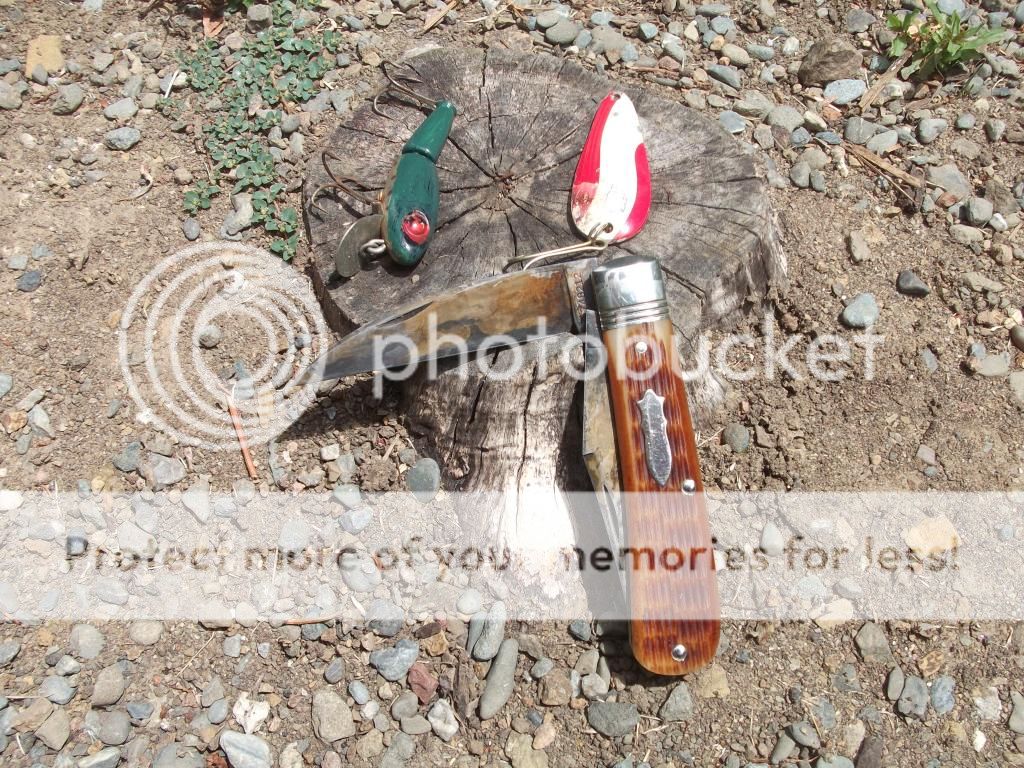

I decided to force a patina on this one. I was getting a little red rust, so I decided to do it up. Used some mustard, Apple Cider Vinegar, and cut some limes. I've never seen a patina like this. I wish the pics did it justice. It's beautiful. The brown swirls really match the scales perfectly.
I haven't been around much, but I have a bunch of knives I've been meaning to put up. This is a good place to start. Now, I gotta put and edge on it. ;)

That came out really good! My Svord's got a nice multi layered look to it, but I've never seen multiple layers AND different colors. Well done!
Might want to clean that up a bit more. That patina looks a bit suspicious, I'd be worried that there's still some acid on the blades that needs to be neutralized.

I cleaned it pretty well. It might need more though. What would you suggest? And FWIW, the brown part looks much more brown in person (less red). I don't know what that means really, though.
Oh yeah, the reason I didn't let the patina happen naturally was because I was getting red rust. I almost thought there was something wrong with the steel. But no one else has had issues. I've never had a blade rust.
I would Flitz that sucker and start over. The brown is active rust as far as I can tell. The steel should darken, get grey, not rusty brown.
You can use Windex. Spray some onto a paper towel and then use it to wipe down the blades.

Windex? Don't have any, but I can get some. If anything else would work let me know. (I like my windows dirty) ;)
So, basically, that would just be to assure that there is no acid left, yeah? After I sharpened (post pic), I wiped it down with WD40.

Hmm. Thanks for the input. I wish I could get a better pic. It doesn't look like rust at all. Just...brown. Or at least it doesn't look like any rust I've ever seen....
