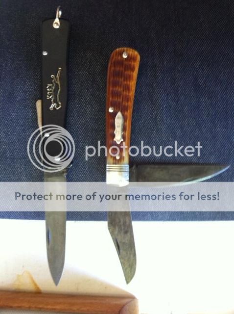

Forced Patina on BF Knife (last year's)
[/URL][/IMG]
[/URL][/IMG]
That patina is a very nice and even grey. Especially on the wharncliffe blade. Is that because you don't cut anything with that blade? My users get very uneven patinas, that change constantly..
I don't cut food with it, I use it for boxes, wood, rope things like that and when I'm done, a light wipe with oil cloth and back in the pocket, it does get some scratches on the scale side of each blade from the creek in my pockets but it gives exposed part almost a tumbled look.
I have a Case CV ABU that I won't in a giveaway here BBC last year this has a nice patina too although it has a gradient effect it is still pretty uniform in its patina. That one I do cut apples and other good with but the patina is so deep it has little affect on it as long I rinse it and dry it right away.
I'd scrub the blade with baking soda & water, to make a paste. The brown looks like it may be rust (to me), and as suggested earlier, the acid may still be working on the steel. Baking soda is slightly alkaline, and will neutralize the acid left. If it is rust, the baking soda usually does a good job scrubbing it off. The rust left after forcing a patina is usually pretty loosely bonded to the steel. Baking soda will take some of the darker patina away also, but the stuff that stays behind is what will be the most durable anyway.

I would Flitz that sucker and start over. The brown is active rust as far as I can tell. The steel should darken, get grey, not rusty brown.

I agree with the gents. That is the wrong color for "patina". You look to have some red rust in there and not just black rust.
Either recommendation of the gents above is good, especially the baking soda.
Windex is good.
If you happen to have Bon Ami cleanser, you can use that. But ONLY Bon Ami. Do not use Comet or Ajax. Comet and Ajax contain chlorinated compounds. Bad juju if you are trying to fight rust.
If all else fails you can use toothpaste. Use the white paste kind, not one of the gel types. The white paste types are alkaline.
Steel is stable in alkaline environments = high pH.
Steel rusts quickly in acidic environments = Low pH

I usually let a patina form naturally but I have done a couple forced. Its extremely easy.
First step CLEAN with acetone. This removes all oil/grease/contaminants.
Next step fill a plastic container with vinegar and heat it so its not scalding but hot.
Dip the blade for about 60 seconds and pull it out immediatly dip in oil or rinse under cold water.
If you pull it out and let the vinegar begin to dry you will notice colors and patterns form.
One thing Frank told me is the black rust comes from the lack of oxygen. Please, Frank, correct me if I am remembering wrong.
So, its important to let the vinegar do its job with the blade submerged and then get it off before exposure to oxygen.
This WILL give you a gun blue finish and it will be perfectly uniform.
The red and brown rust is not good.
I hope this may be off some help. If I was you I would polish that down and start back over. Then let the natural use set in all the patterns you can imagine.

Right on. Thanks fellas. I think I'll go back and try again. Or just let it go au natural. But it's coming off.
Jon Slider,
I had that same problem when I tried to go dark and not just a quick even grey. The solution that I found was simple. Hot vinegar dip for about 60 seconds, removed buff dry with a clean rag. Do this over and over until its as dark as you want. It will come off with hard use but not just polish or a rag.

OK, I just re-forced the patina. Looks nice and grey now. HOT ACV. Did a mercator I had still shiny, too. Pretty cool. :thumbup:
