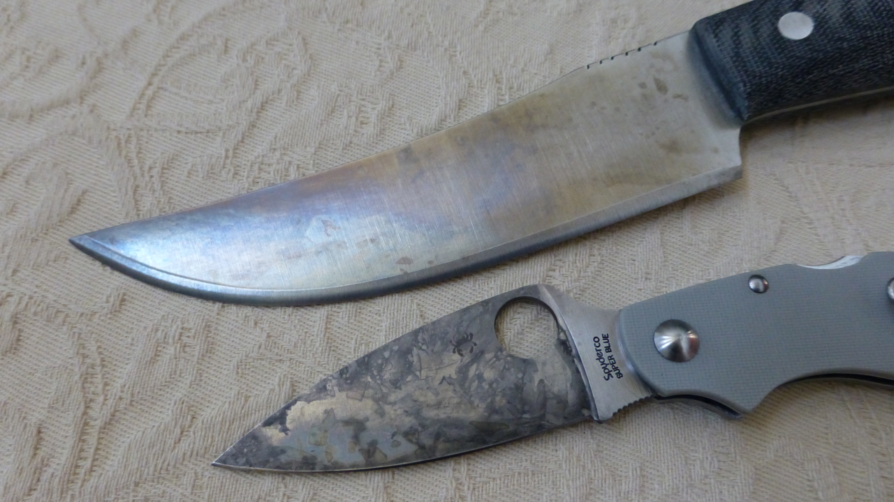

I really like natural patinas that come through use. Here's how my Galley Wag is coming along, next to probably my favorite patina on a Super Blue Spyderco. Pictures don't do it justice with all the color variations and layers.
P1070706_zpsbde925c0.png~original
