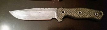

Just received an INFI and SR77 Big Finish MMD. Love these choppers, they are exactly what I was looking for. They will most likely be users. Because big knives require more maintenance, I'm thinking that I want to put a forced patina on the SR77 because I'm thinking it will help to slow corrosion when in use.

Shortly after vinegar patina
After use. It hasn't rusted at all, simply gotten darker. Experience from 1095 says that the blade can still rust but acts D2 where it doesn't pit unless you sit it something that corrodes it. I think the rougher patina'ed surface holds oil a bit better than a shiny surfaces but a polished surface sheds water very well. Stone-wash is about the worst for corrosion resistance as far as finishes go.

I've never blued S7 but I have blued SR101. I'll bet they'd act similar. Here's a 711 with cold bluing. I like the way it performs. If you wear it down to shiny steel, just clean up the blade and wipe it down with some more bluing agent. The only downside I've heard with bluing vs patina is that a blued blade may not be food safe. I don't know that for 100% but I've seen it discussed.
The 'rat in the back has a forced mustard patina
