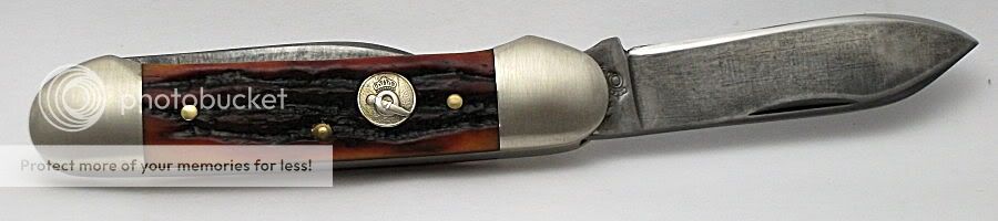

This is pretty much how I produced the patina on my 8OT's clip blade, though not quite to boiling temperature. I took advantage of the vinegar & water mix left over in my coffee pot, after using it to de-scale the coffee maker. Used roughly 1 part vinegar to 2 parts water. It was at about 180°F as it sat in the pot, and I dunked the blade and held it in there for maybe 30 seconds - 1 minute at a time, and repeated this about 3 times. Did see the bubbles from the blade too, which is pretty impressive and just a wee bit scary. Lifting the blade out of the liquid (exposing it to the air), you can actually watch the steel darken before your eyes as well. Blade will be BLACK after this; rinse thoroughly in cold, running water, and then scrub it with baking soda, which neutralizes the acid (very important; you'll get RUST if not doing this, and being thorough about it). After scrubbing with baking soda and otherwise cleaning everything up (plus some stropping, which shines up the edge), my blade looks like this:

I believe you might be correct in this, David. This Queen Canoe that I just gave away was sanded a little bit before I forced a patina with vinegar.
I was originally going to give the blades a satin finish, but after beginning to sand, I noticed there was a very faint patina that was forming. It seemed kind of silly to me to go through all the trouble to sand it if it was going to patina anyway, so I decided to force it instead. I wrapped a vinegar soaked paper towel around the blade and left it for a couple hours (mostly because I forgot about it:eek:). I had to do it a couple times and make sure the paper towel was wrapped tightly and evenly to avoid splotching. This method works much faster with simple carbon steels.
