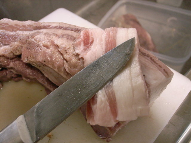

An example of naturally formed patina.
Not stainless does not necessarily mean stainfull.
