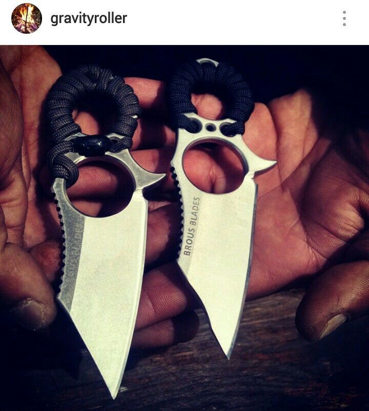

RE: Brous SSRv2 in D2 on left (below).
The spine above primary grind was done with PCB etchant (highlights the primary grind & de-emphasises mfr logos. Also increases grip traction in pinch grip.

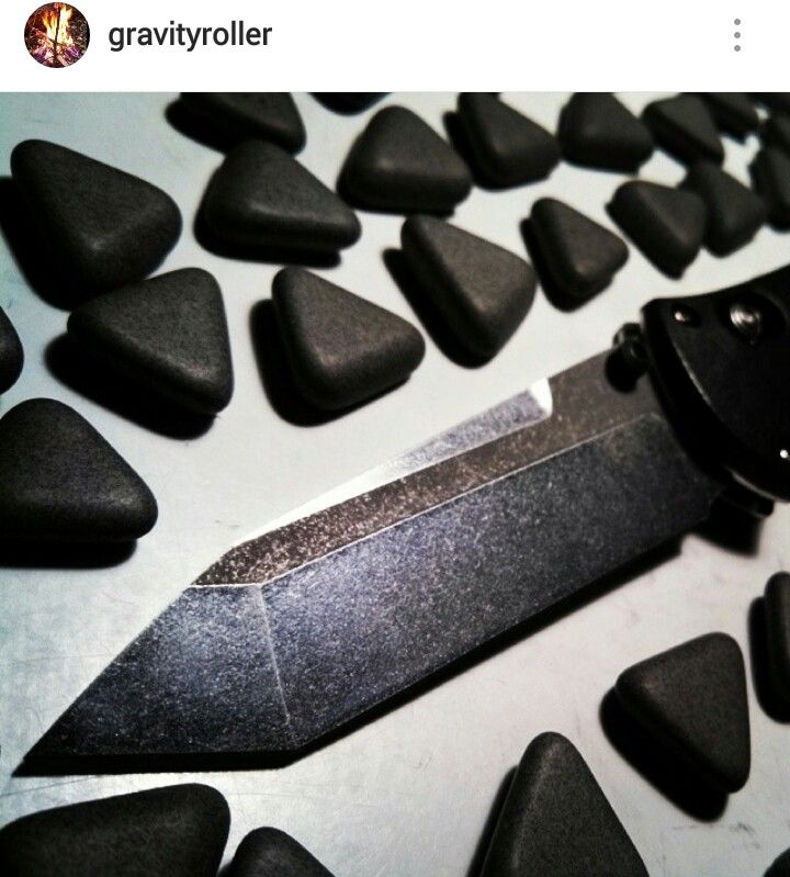

RE: Benchmade Barrage (below).
Multiple levels (darkness contrast to light) on this blade Dark/Lighter/Satin.
154cm in my experience reacts similarly to D2.

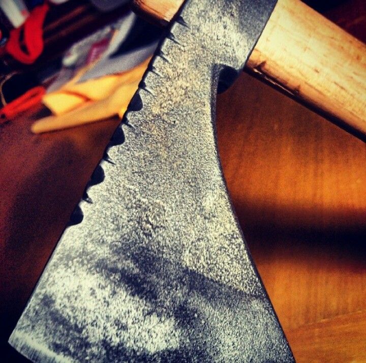

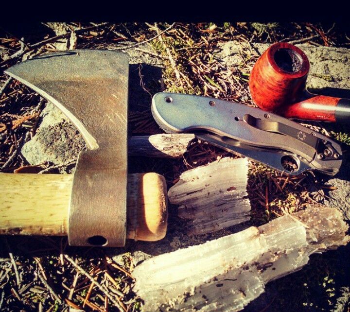

I use a crock pot (outside) when I use hot cider vinegar to patina. pic below of a couple hawk s done this way (1055 carbon steel if I remember correctly). Got some nice yellow-hues with tones of brass (I think from something in the apple-cider).
Pipe Hawk
Frontier Hawk
