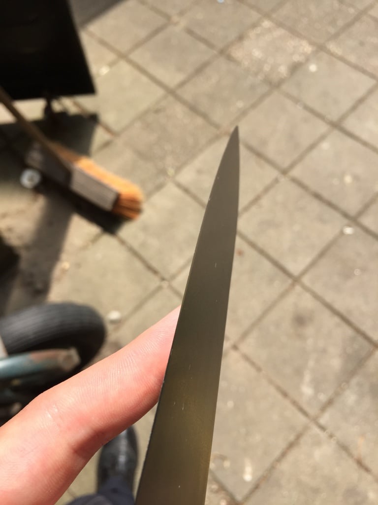

Today i tried my hand at sharpening the knife, and that did take me some time as the material is both hard & very wear resistant.
First i removed the "factory edge" by cutting a few times in the side of my Tormek Black Silicon stone, after which i ground a completely new edge on an experimental rubber wheel coated with 230 grit diamond powder.
Afterwards i refined it with 2 Paper Wheels, one with 15 micron diamond compound and one with 6 micron diamond compound, and then i removed the tiny (but extremely stubborn) burr with a third Paper Wheel with 1 micron diamond compound.
On every kind of steel i know of this procedure would have resulted in a semi-polished edge in which text can be read, but on this metal the edge at best just took somewhat of a satin finish:
The darker line in the edge on picture 2 is just the light playing tricks, as the whole edge looks like the wider grey area in real life.
Sharpness wise the edge can now shave the hair on the back of my hand in two directions, as well as slice single-ply toilet paper, also because the edge is still quite toothy.
Soon to be used in our kitchen.

For the last month and a half i've used the Forever Titanium Hybrid knife in our kitchen almost exclusively (coupled with a reground Spyderco paring knife), and i must say i'm quite pleased with it.
The model & size are very handy for what i use a kitchen knife for, it cuts very well because of the thin blade geometry & 25 degrees inclusive edge, and the blade material keeps a slicing edge for a long time.
Today i resharpened it for testing purposes, even though the old edge was still sharp enough to cut tomatoes.
As far as i could see through my Victorinox loupe the blunting mechanism seems to be microchipping, but this happens only very slowly and on a very small scale.
The chips aren't visible with my naked eye and are actually helping to prolong the aggressive slicing edge this material naturally seems to like.
Since i wanted to find out how silicon carbide would do with this blade material i took it to my trusted Tormek T7 fitted with the SB-250 Black Silicon stone, and to keep it short: the stone ate the Cera-Titan for breakfast.
My stone is graded to about a 1000 grit, and in only a few slow passes per side i had a nice burr.
Removing that burr took noticeably more time (the titanium matrix is very resilient), but with some 1 micron diamond compound on the leather wheel i managed to slowly abrade it away.
The resulting edge could just shave the hair on the back of my hand on skin level, which differs from the same sharpening procedure done on a good VG10 kitchen knife, as that almost always produces a treetopping sharpness.
Now i haven't tested this edge in our kitchen, just cut some triple, double, and single layer toilet paper, which it all did just fine.
I then proceeded to refine the edge with 15, 6, 3, and 1 micron diamond compound, all on dedicated Paper Wheels, and the edge can now whittle one of my chest hairs in the direction of the root, not towards the hair point.
It also slices single layer toilet paper very well.
Maybe the material can get even sharper with more refinement and/or different methods, i don't know, but i'm also not sure if that would even be useful, knowing how this material tends to behave.
My guess is that the current sharpness will also vanish quickly again to settle for a long lasting working edge, but i want to find out if the extra refinement steps make any difference in that degrading process.
My plan is to use the knife with this edge until i can no longer slice a tomato well, which to me is a good test method for a kitchen knife.
Later i also plan to lend the knife for a while to a professional Chef to see what he thinks of it, with a fresh edge of course.

The knife has been used for about a month during our holiday in Germany & Austria for cutting all kinds of food on a simple plastic cutting board.
It performed perfectly until one of the last days i tried to slice one of those large German breads: very good food, but these have quite hard crusts.
Parts of the edge rolled a bit, but no chipping as i more or less had expected.
Back at home i resharpened the edge in 3 steps: Rubber Wheel with 230 grit diamond powder, Paper Wheel with 15 micron diamond compound, Paper Wheel with 1 micron diamond compound (deburring)
The result was a treetopping sharp edge, and in this condition the knife was then loaned for about a month to a professional chef.

Pictures of the knife, taken by Patrick on day 3:

The knife cuts well, but what is remarkable is that when i cut like i was learned i can feel that the knife chooses it's own direction, like a knife sometimes does when the tip is bent.
(an a-symmetric blade can have a tendency to do that in certain situations - kwakster)
But as you can see i did both rougher & finer work, and the edge remains in very good shape in my opinion.
Update 2 (after a month of use):
I have been using the knife on every single working day (5-6 days in one week), and i think the edge is now come to the point where it doesn't get any more blunt.
I didn't notice any difference while cutting and i also can't see any changes in the edge with the naked eye.
It is exactly as you told me: i can still cut tomato's with it !
But only with a slicing motion, as when i try a different cutting technique i can notice that the edge is less sharp.
All in all i think it's a very nice knife (which took me a while to get used too)
