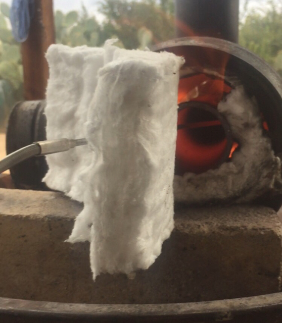

However I just spent 4 days with Tai Goo In Tucson and I want to tell you that I watched him control the temp of his VERY simply built forge with an inexpensive burner to within a few degrees of change and over more than ten minutes.
I took pics and video taped this. The only thing that wasn't verified was the accuracy and repeatability of the temperature gauge.
Anyone else able to accurately control a soak time in a forge?
Yes. According to the temperature gauge, easily within +/- 5*F for as long as needed.

That same forge is there but we used a small propane one for the small blades we worked on. Yes he uses the muffle and the heat was amazingly evenly distributed. :-)
Tai is a good chap, but he marches to a differet ukulele player than most folks.
He also uses procedures and materials that aren't the standard practices.He has learned how to do this, but it isn't necessarily the best practice. Look at the image shown of uncoated mineral fiber blankets being used for one example.
That aside, many folks with a forge hold to +/- a few degrees. The plans and info are regularly discussed here. There is a sticky with the plans on my two-stage PID controlled forge in the stickys. Many have built it and clones that work almost as well as a HT oven.
I saw the late John White use a small version of a Fogg forge that held the temp within 3 degrees for the time required to soak a big W2 blade with a hamon. It was made out of something the size of like a 30 pound propane bottle like you would use on an RV IIRC.
If the forge is PID controlled, the PID is the readout. Some have a read-only TC and readout. Depending on the TC and the shielding, these vary in accuracy. Others use hand-held TCs and laser guns, which are not very accurate at all. Some folks just guess at their forge temp. Even a very good readout and high quality TC are only accurate to +/- 5 degrees at 1500F.

Specific to using something like a muffle in a coal forge, how would you monitor the blade temp to within a few degrees, and how would you get that kind of control? Would the TC be measuring the temp of the bottom of the pipe where the blade is resting or the blade itself? As coal is consumed, does controlling airflow provide fast enough combustion control to keep the temp in a small range, or does the coal fire have to be large enough to remain stable for 10 minutes after you're gotten the airflow to stabilize at your chosen temp?
I think this concept is great, I'm just trying to figure out how it works when the muffle is conductive iron and the blade is resting on it, as well as the problem of measuring temp at the blade.

you are asking important questions that are difficult to answer here and require you to experience some on your own, finding your own way.
I can't speak to a coal forge, We were using a propane forge with a fine flow adjustment.
monitoring was simply done with a standard thermocouple, getting that control requires experience and trial and error.
the T/C was measuring the air in the muffle.
I would suggest you try the muffle concept with a T/C and see what you can get independent of working with a blade.

It strikes me that if you are measuring air temp within the muffle, it might be a mistake to assume that the blade is heating to that air temp if it is in contact with the iron tube, which is lying in the fire. A layer of refractory clay on the bottom of the muffle would prevent metal to metal conduction and put the blade closer to the TC temperature, since both the air and clay/firebrick are going to change temperature much more slowly than the metal pipe.
It's important to remember air is a very poor conductor of heat at 1500f.
Clearly anyone adopting new equipment needs to come up with their own regimen for doing it. I was just trying to understand the claims being made in terms of equipment and results.
What is the impact of metal to metal conduction?
I don't know. If it's a mistake or not....what I do know is what I saw, and what was measured and what was heat treated and what was tested.
I saw a blade heat evenly inside a muffle and held to that temp for a 10 min soak. And we did this twice.

If the goal of the muffle is solely to make observation of decalescence, then resting the blade directly on the metal tube is good way to transfer heat quickly.
But if the goal is to maintain a steady blade temperature for a longish soak, then insulating the blade from the tube might make sense because it connects the TC measure of temp to what is actually heating the blade, as well as damping heat source temp changes.
Not arguing - I'm asking: If you were measuring the air temp in the muffle, how do you know what the blade temp was during those 10 minutes? The air wasn't heating the blade, the iron tube was through conduction.
If that isn't what was happening, then I'm misunderstanding the set up being discussed and would like to know what the actual set up was.
The difference between the muffle and a heat treat oven is that the iron tube is the equivalent of the heating coils in an electric oven. You wouldn't put the blade directly in contact with the heating coils in an oven, so I'm asking what makes measuring air temp the equivalent of measuring the temperature of the blade since it is being conduction heated at a greater rate and efficiency than the air is.
Ok. We are measuring the air temp in the muffle with a suspended thermo couple.
To me the air was heating the blade. The blade was in the muffle spine down vertically. The blade heated up evenly
