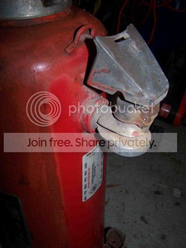

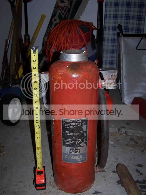

I've been looking to build an Indian George-style forge for a while now but couldn't seem to find any suitable scrap tubing. As I was pulling into my garage tonight, lo and behold, there is an old steel fire extinguisher body that I salvaged from work for whatever reason. I'm wondering if this thing is worth the trouble? Does this thing have forge body potential?:confused:

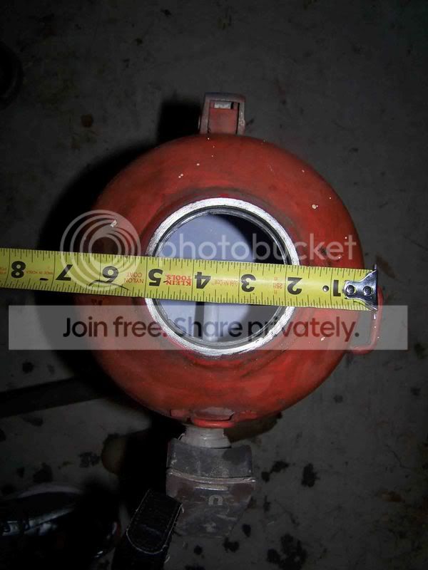

It's cleaning up nicely, folks. I, on the other hand, am covered in "Purple K" (the extinguishing agent).:D I am hacksawing off the cone at the end because I can fit my hand in the hole in order to eventually line the sucker; not too bad, the steel is soft enough.
How crucial is the location for the burner tube hole? Is a couple or four inches to the opening too close? I'll snap some more pics but it may be a while due to the holidays.
