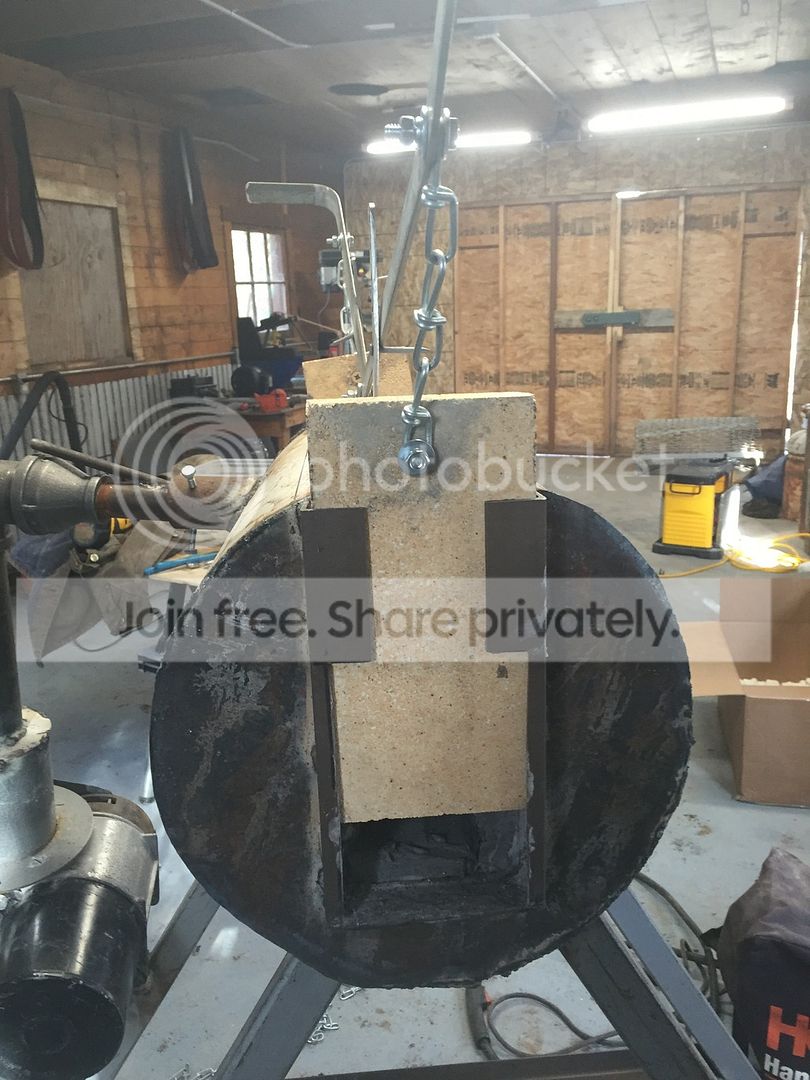

I'm planning on a 4x4" rear port and a full diameter front port, but would like to be able to close it off a bit when working smaller projects (knives aren't my only work). Has anyone built a vertical sliding "door" out of hard firebrick for their forge ports? If any of you have can you post a pic or design suggestions? If any of you have tried and found them to be more trouble than they were worth, or didn't work as planned, please explain.

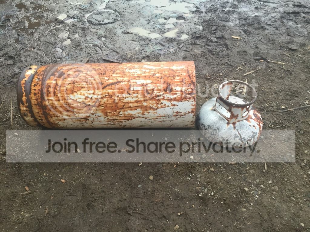

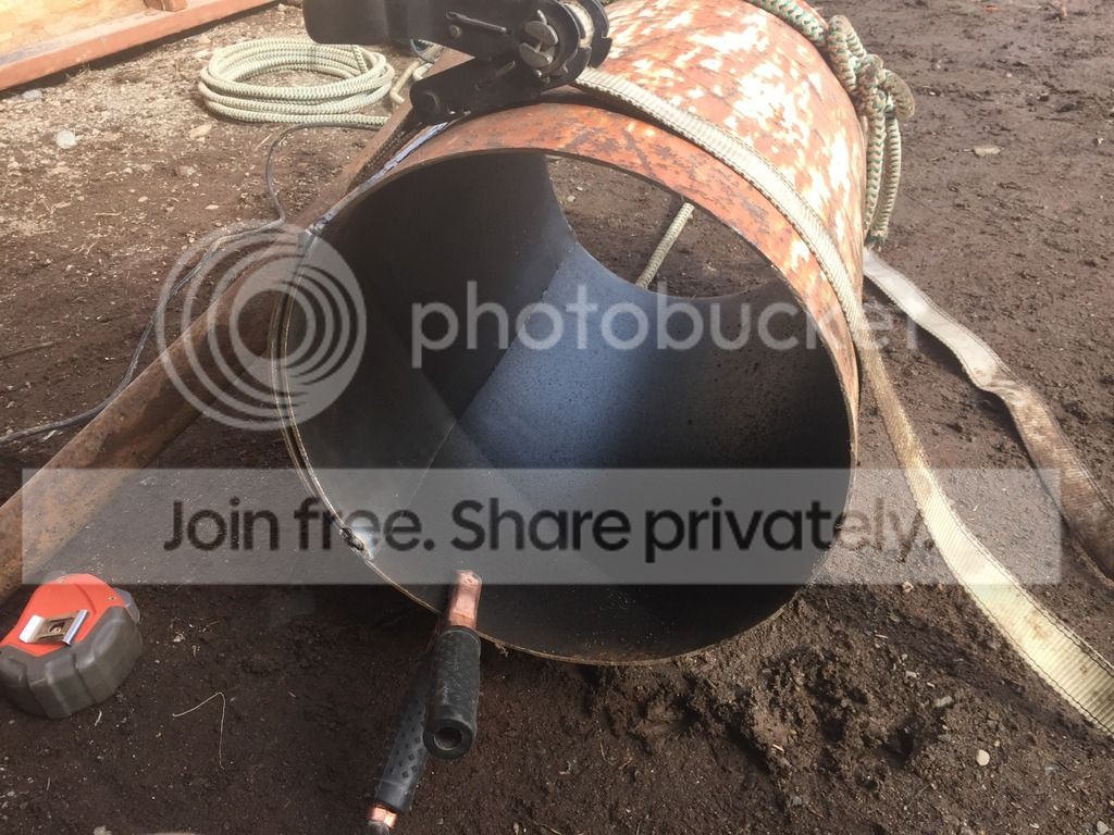

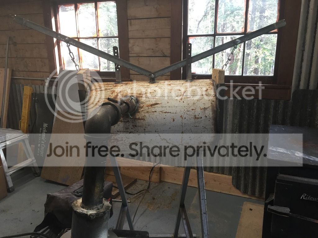

I'm using an old 100# propane tank. I filled it with water (to prevent unnecessary excitement) and used a cut-off wheel to open it. If you don't know, garlic oil (the odor added to propane) settles to the bottom of old propane tanks. I heard complaints about the smell from neighbors at the far end of the runway!:o
The tank was too big around, so I slit the side, rolled it tighter, and welded it together again.

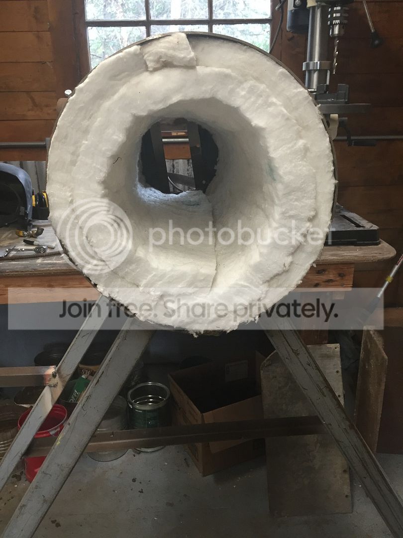

I got my stuff from High Temp Tools yesterday, so Today I installed the Inswool and put on the first coat of satanite.

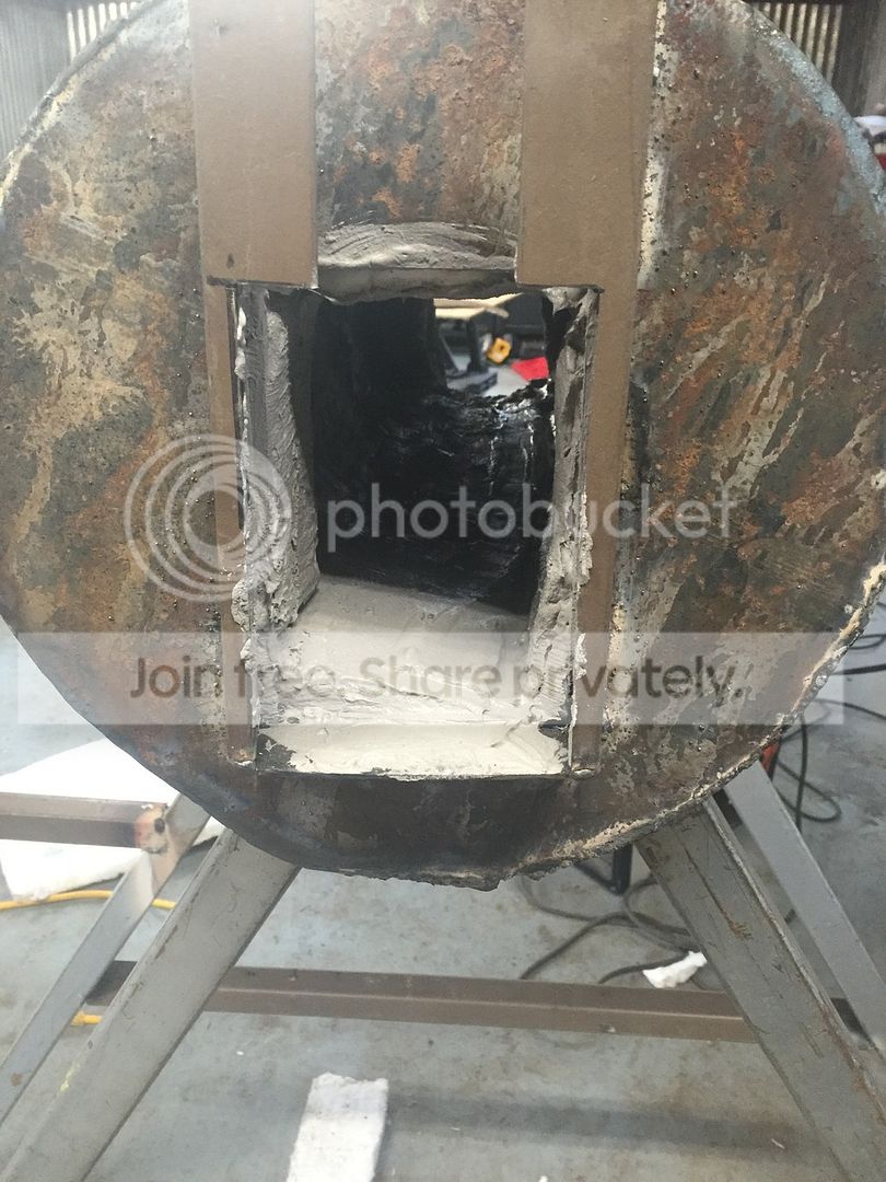

I did something a little different than usual with the openings. We'll see if that idea was either brilliant or really stupid when I fire it.

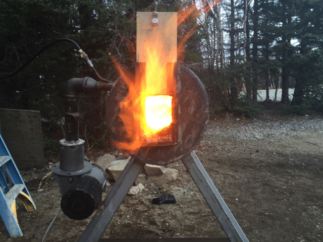

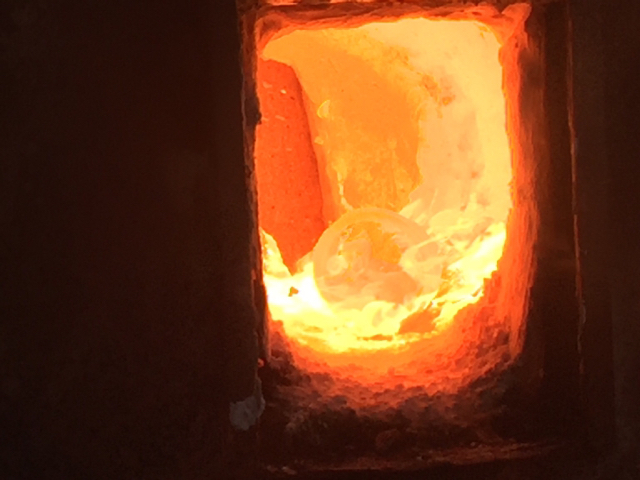

Haven't had a chance to update this thread due to my work (maintenance at a summer Bible camp). The waste oil forge is a success! Once adjusted, it runs smooth and clean. I can turn it down so that it runs steadily just under non-magnetic, or I can crank it up till I get sparklers (too hot) and just about any temp in between. I can run it a tad rich or lean, so controlling the mixture isn't a problem. It does smoke a lot when first heating up or if I don't dilute motor oil thin enough with gas or diesel, so running it indoors is not an option.
First time firing it! Running a bit too rich.
Running at a relatively high heat.
And soaking along at a low heat.

It works pretty slick. It not only allows larger projects, but helps with high and low temps. If I open both while running on low, it helps me stabilize the temp just below non-magnetic. If both are nearly closed on high, it gets really hot. I never guessed that controlling the escaping heat would make such a difference in temps. Next step is installing a TC to help me with my temps. Setting and holding any temp doesn't seem too hard, but knowing what that temp is a bit of a bear when you live in the land of the midnight sun.
Are thoes wood stove fire bricks for the door (hard fire bricks) if so I would be a little cautious because when you crank the forge to max for a welding temp and thy will melt (don't ask me how I know). I thought thy where rated higher then thy are which is only like 2000-2200°. Your forge looks good, any info on you oil burner you can share. I'm going to be building another 1 or 2 forges coming up here in a little while and need much larger openings. I'm thinking about doing a ribbon burner forge on a table so the forge body can be what ever shape I want or need. I also need a verticle forge with a larger opening. I'm at 3"x3" now and need more room for larger Damascus billets. Let's see your burner
The bricks are the hard fire brick sold by hightemptools. I can't remember off the top of my head what they are rated for, but I'm confident it's better than 2000*F. I can give more info later, but the burner is a slightly tweaked "hot shot" burner from backyard metalcasting's website (link in first post). The key to getting it to burn well is "cutting" the waste oil to a thinner viscosity. Diesel works ok, gas works better. If I had a larger inlet port or a higher pressure blower, I think it would burn the thicker stuff better- my limiting factor seems to be the velocity and volume of air I can move with the blower (came off a Becket oil gun that was set up for .5- 1.75 gallons per hour).
