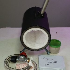

Hey guys I'm a noob and need some direction. I'm going to build a forge for knife making. My plan is to use either some 1/8 iron plate or a piece of 8" .188 wall pipe for the exterior. I plan on failing numerous times at making cable Damascus before getting it right but my question is kaowool or firebrick?? What will endure borax fluxing better or longer??

One thing to keep in mind is there are different sorts of firebrick. The hard ones for wood stoves at the hardware store provide minimal insulation, and are only good until 2300 degrees or so.
Insulating fire bricks (soft firebricks, furnace bricks, kiln bricks, ect) provide very good insulation and come in various grades. The ones I've got a pile of for example are good to 3500. These are quite a bit more expensive, and are what we (generally) mean when talking about bricks.

Wool is definitely easier though, and it's my understanding that the bricks are (at least somewhat) more resistant to flux.
For what you're wanting, 12" length of 8" pipe, 2 square feet of wool, 1 lb. of mortar and 12 ounces of kaolite, and a Graham 100k burner will make a decent welding forge.

This is the most basic forge from your available materials. I use Rutland 3000° refractory mortar to line the entire wool, and Kaolite-LI30 to build a 1/2" thick bottom that is flux resistant.
