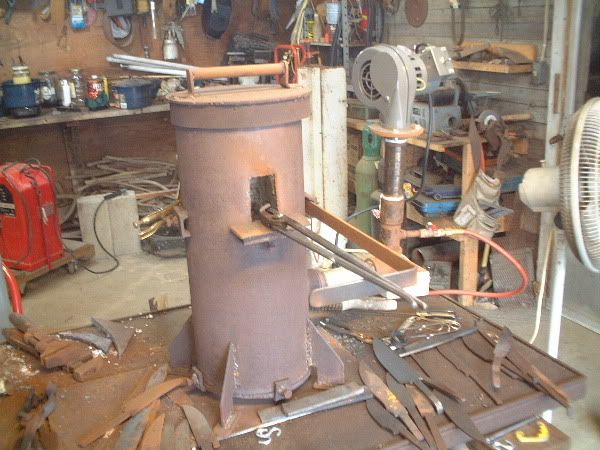

You might be interested in going vertical:
Only one burner and a small blower and I forge down 1 inch thick steel into 10 inch blades with no problem:
karl
Man that is a nice looking forge. What is the diameter of your forge? I notice a piece of square tube sticking of the back, what is it for? Can you heat treat basic steel (1095, O1, W2) in 10" blades? On the top of the burner pipe, close the the forge side wall it appears that there is a piece of red tubing coming off, what is this for? Thanks for helping! I am very thankful that you guys are all helpful. For a new guy like me this is really an adventure. I really have the knife bug and want to start forging and want to build a forge once and get it right, I hope. Thanks!
Wow, I had to look at that close! No, that red tubing is the handle of my hand truck that holds the 100# propane tank.
There is a hole on each side of the forge, so that you can pass your blade through and heat up whatever part you choose. I ran it for about a year with both ports open until I had a brain storm that I was losing 1/2 of the heat out the other hole! So, I just clamped a square tube to the hole and closed it off on the end, which still allows me to pass my steel through the forge without losing heat in the steel.
I think that is about 8 inches in diameter, but with a layer of wool all the way around, that dimension reduces. You can still heat up way more steel than you can forge down.
I have no problem heating up my blades after forging when I do thermal cycling/normalizing cycles.
I'm sure you could heat treat with a little practice.
I personally use an oven, but would not be afraid to use the forge if I had to.
Yes Karl tell us more or let me guess. It looks like you just welded a piece of in this case square tubing to the rear door of you forge with the other end closed at least that is what you said. this then lets you pass a longer piece of steel completely through the forge into the pipe so that you can heat a blade or bar up that is longer than you forge is in diameter without losing heat out the back. I assume that there is no insulation in the tube? very cool er hot idea
Bill got it right, except for the welding part - it's not welded on. I DID weld a little plate on the bottom of the tube that is clamped to the ledge right under the opening so I can remove it if necessary.
Correct, it is not insulated. As well, on the end, I have a cap that has a bolt attachment that I can remove and even pass through the tube if I want.
This cut my fuel use by about 30% and raised my forge temp at the same pressure.
Also, note the piece of channel I have welded to the side that holds the tong support. that's self explanatory. But, the reason I have that ledge at the forge openings is that I also have a similar piece of channel welded underneath them with a bolt in them. this was originally for a piece of stock that was to have a small fan attached to it. This was to blow the flame to the side away from the blower motor, which can get a little hot from radiant heat from the forge. Right now I just use that pedistal fan to blow from the side.
that make sense?

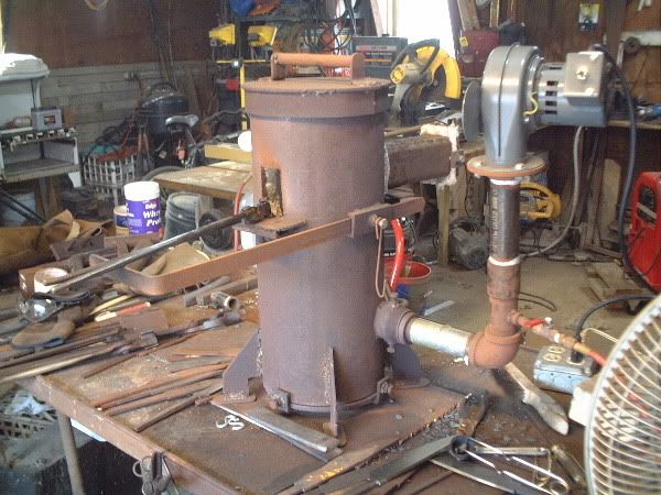

note in the bottom picture that the fitting for the flame tube is NOT right in the center of the forge body, but rather off-set. This causes the obvious swirling vortex of the heat as it rises and gets good combustion that way. It is not directed straight across the forge cavity.
