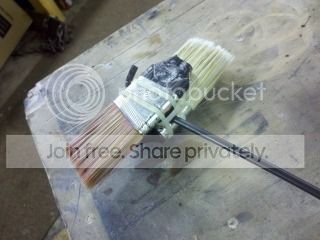

Not sure if this has been invented or not, but I made one to coat the inside of my new forge with satanite. I will also use it for the ITC100.
Here a picture is worth a thousand words. Chuck it in the hand drill and bingo.
3 zip ties, two paint brushes, and some quarter inch rod.

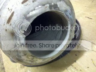

It really made the coating go on smooth, the ripples you see in the photo are from the blanket not the satainite.
Thats prettymuch how i did mine, but with one brush
I fixed a toilet brush onto an 12" piece of hex rod to accomplish the same. The toilet brush is the stiffest I could find. Most of the bottle brushes were too soft to work right.
