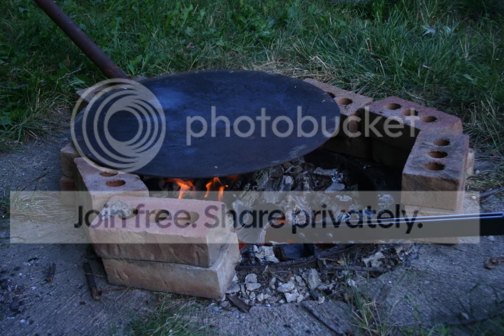

I went through 38 pounds of charcoal when making this:
Of course, it wasn't really that proper a forge:
