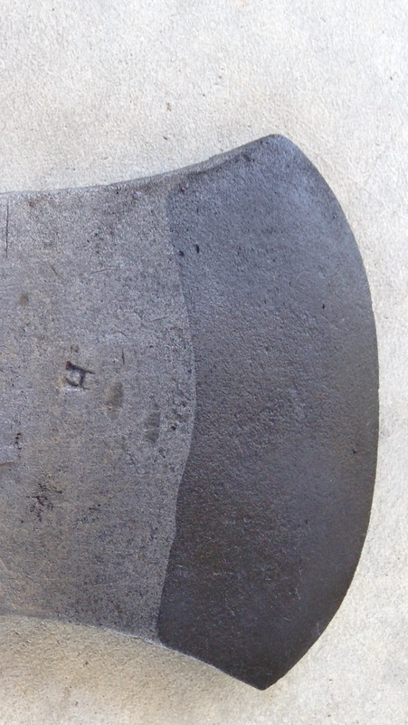

That's from someone sharpening it on a bench grinder, and this axe would've been drop forged from one single piece of steel.I picked up a 3 1/2 lb Craftsman last week that I think dates to the 1950’s. After a little love from a brass cup brush and some vinegar I found an unusual pattern about 1/2” from the edge of the bit.
Is this mark a forged weld between two different pieces of steel?
View attachment 923433 View attachment 923434 View attachment 923436 View attachment 923437
What about the straight line above his thumb? Is it on both sides? I like that Craftsman logo.

If this Craftsman axe was made by Vaughan & Bushnell it would have an M at the end of the second line of text in the stamp. ( It's just for the M placed here and only designates Vaughn on Sears / Craftsman tools )Could it be made by Vaughan ,didn't they have an electric weld of some kind?
