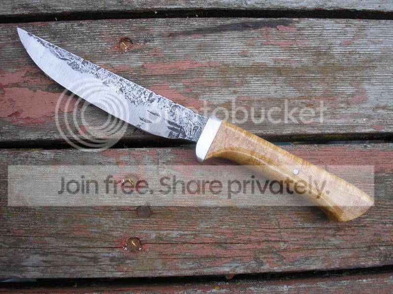

tai goo can get them pretty good:

I think I remember seeing that knife of Tai's on the board. Holy crap! He's good with the hammer!

Does Lively forge those exactly to that shape, or does he clean them up with a file? Those bevels sure are crisp if they're not filed!
Yes, All of Tim's knives are forged as you see, no file cleanup on the bevels, just cleanup of the silhouette. Forged to shape like and keeping the bevels crisp like that is QUITE tricky.

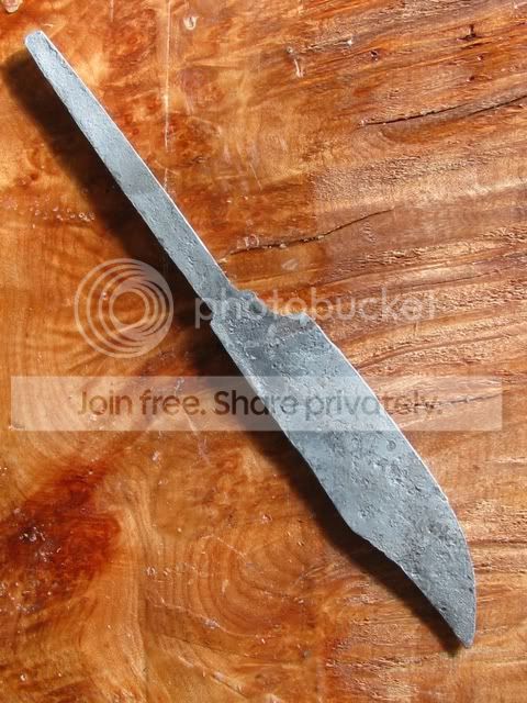

This is a mini-bowie I did for a demo on Primal Fires. All I did was file the edge, square the shoulders and refine the tang distal taper.
