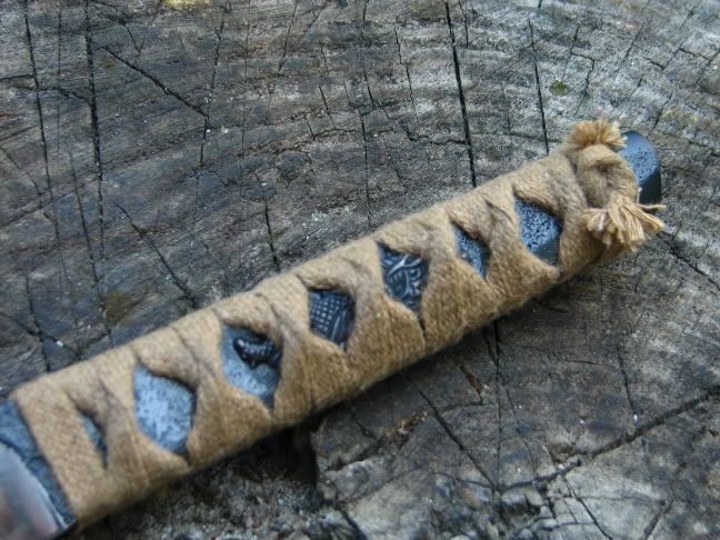

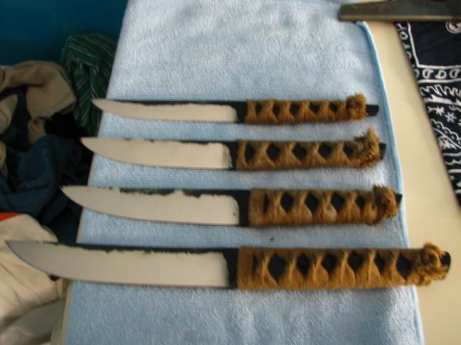

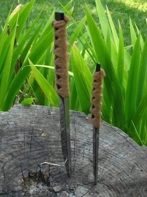

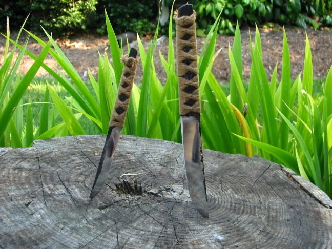

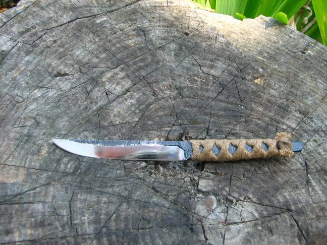

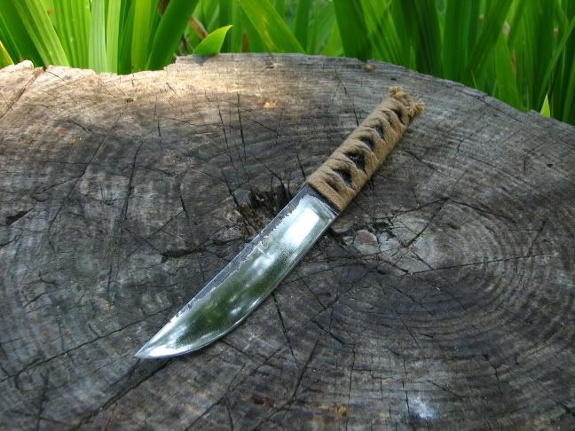

Hello all,
Here is a recent project...turned out pretty nice.
Big Leaf
Length: total 10 1/2" blade 5 1/2"
Width: blade 1/4+ handle 3/8"
Little Leaf
Length: total 7 3/4" blade 4 1/4"
Width: blade tapered 1/4"-3/16"
Steel: Truck leaf-springs (hence the name)
Steel treatment: Differentially heat treated, tempered
Finish: buffed high polish
Handle: Wrapped
Both knives are sold! thanks yall...if you are interested in some like them let me know.
$115 for the big leaf
$75 for the little leaf
Please email me with your offer at Knifemaker87@gmail.com
also, commments on the worth of these knives would be helpful. thanks
These are the first knives that i have made with my new grinding belts. Before this all of the knives have been made with 80 grit sanding beltsa and aLOT of hand sanding. so this is very nice. the next step will be to get the hammon in there. it is there....just not very clearly. I used plaster of paris (i am getting some refractory cement) so it wasnt a very good clean hammon. comments are welcome...how can i improve this design?
thanks for looking, and send me and email with your offer.
~Chris
