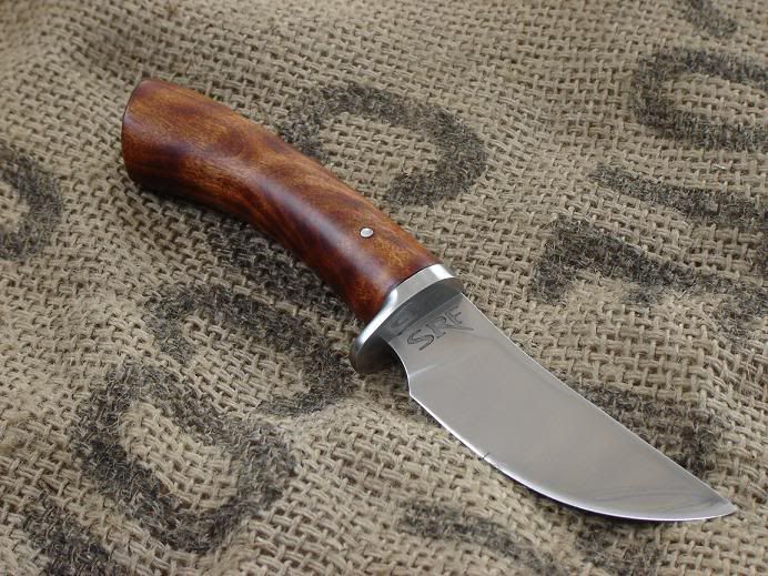

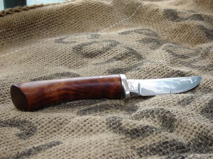

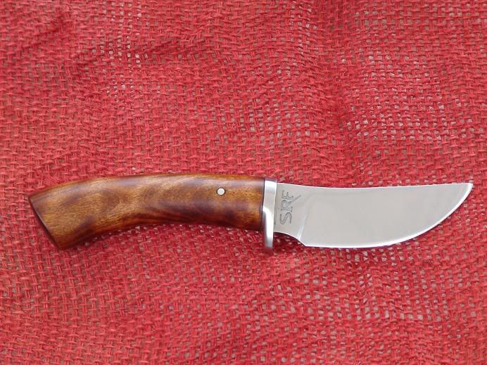

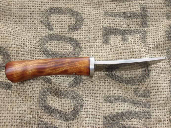

Sometime ago I beat out a few RR spikes as practice, but this is my first actual forged knife completed. Though W2 is water quench I didnt use water, water scares me:eek: I normalized 3 times and double quenched in a custom oil blend. Has a real nice temper line but I did not use ferric on this blade so it does not show in the picture.
OAL : 8 1/2" (21.5 CM)
BL : 3 3/4" (9.5 CM)
Coal Forged W2
Curley Cherry
Stainless steel gaurd and pin
Convex cutting edge
Took these pictures this morning , light was a little better
Thanks for lookin
